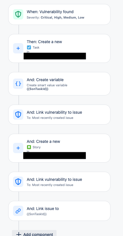

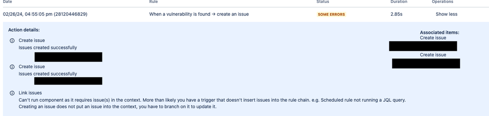

Peter Loh
February 26, 2024
Hey @Bill Sheboy
Just an update on my end. Seems like setting the variable to {{createdIssue.key}} isn't working. Logs are showing
Wanted to see if you may have any other ideas?
Bill Sheboy
February 27, 2024
Would you please show the complete audit log details and your full current rule image for context?
I suspect there may be a missing / incorrect branch.
Peter Loh
February 27, 2024
Hey Bill! Attached is the audit log detailed and current rule. I just redacted the ticket # and project.
Let me know if anything else is needed.
Bill Sheboy
February 27, 2024
Yup, there is a missing branch to most recently created issue above that Link Issue action.
Please see some earlier post above for the full context:
https://community.atlassian.com/t5/Automation-questions/Re-Re-Jira-Security-Linking-Issues/qaq-p/2616822/comment-id/9491#M9491

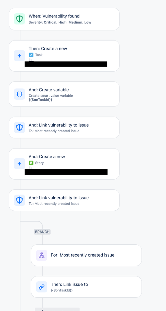

Peter Loh
February 27, 2024
Ah apologies. I missed that. I went ahead and added the branch. Thanks again for the help, Bill! Let me know if this is set up correctly of if I did it wrong.
Like Bill Sheboy likes this
Bill Sheboy
February 27, 2024
That looks correct now.  Have you tried testing it yet?

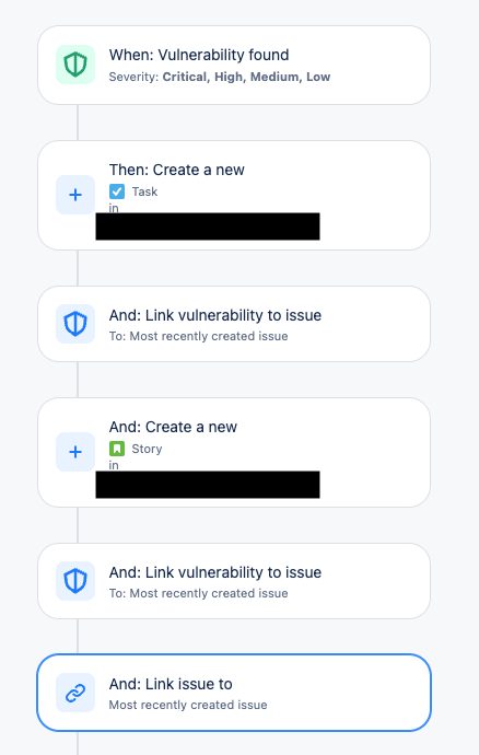

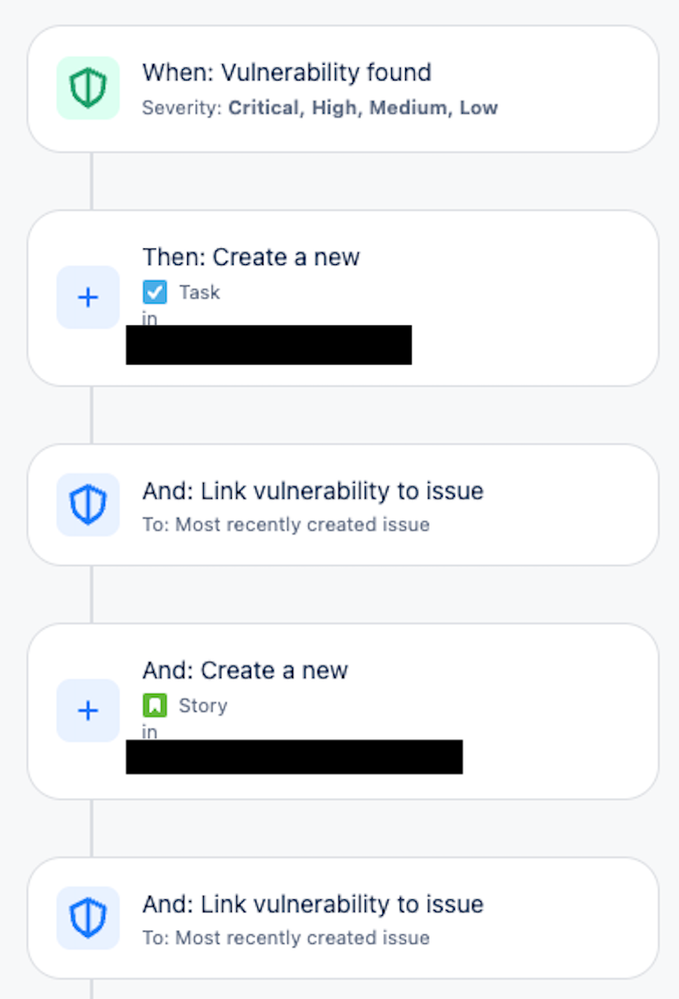

Peter Loh
February 21, 2024
Thanks Bill! I have not tried using the smart value. How do I go about knowing what smart value to use? So basically link the story to the task.
Bill Sheboy
February 21, 2024
Looking at your rule image, you want to link the second created issue (a Story) to the first one (a Task).
In this case, you can try linking with "Most Recently Created Issue", as that will refer to the one above the action: the Task.
Please try that and let me know how it works for you.  Thanks!
FYI...to use a smart value for linking, you type (or paste in) the smart value, and it will appear below the field.  If you then select the value below the field it will be used.  This technique works for many rule actions which look like they only accept a dropdown list value.
Peter Loh
February 21, 2024
Appreciate the help Bill!
Would we place that step at the end like so?
As for smart value, how do we know the syntax for it? Like how would I know what the smart value is to reference the task? I would start typing "{{ but it isn't auto populating anything so unsure what values with reference what. I am most likely doing this wrong on my end.
