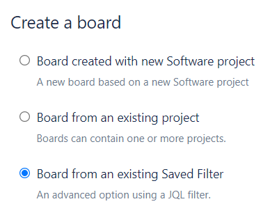

To further elaborate: on creating a new board, if you pick the last option "Board from an existing Saved Filter", on the next screen you get the option of setting the Location to your own personal profile instead of a project - you just start typing the profile name and it'll come up.
This is the specific scenario that's failing now.
Automation rules, supposed to be triggered by Sprints which are running from a board linked to a user profile (not a project), aren't being triggered.
