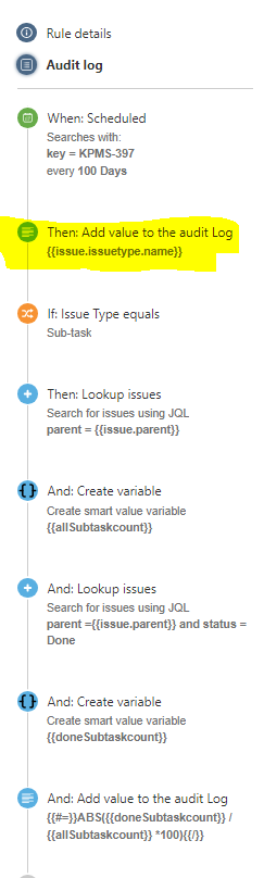

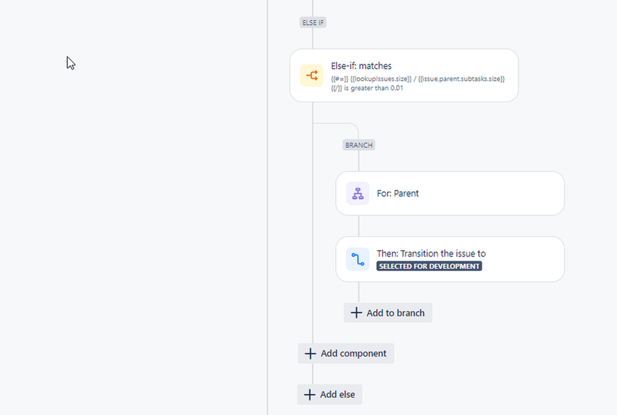

You havent mentioned if you are in Cloud or DC. If you have lookupIssues, its a lengthy but straight forward rule to implement. If you dont have lookupIssues, let us know so we can suggest alternatives.
Assuming you have lookupIssues, try to implement below steps to begin with:
  • Trigger = Issue Transitioned to Done
  • If Condition = Issue type = Sub-task
  • lookupIssues => parent = {{issue.parent}}
  • create Variable => (allSubtaskcount) = {{lookupIssues.size}}
  • lookupIssues => parent = {{issue.parent}} and status = Done
  • create Variable => (doneSubtaskcount) = {{lookupIssues.size}}
  • Log statement => {{#=}}ABS({{donesubtasks}} / {{allsubtasks}} *100){{/}}
If you can get upto here, next is a series of If Conditions & Branch steps.
So try to get started with the rule, refer to screenshot and share screenshot of your rule / audit log at least until above steps and we can proceed further to do If Condition/Branch evaluation.

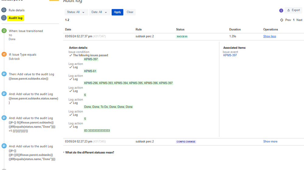

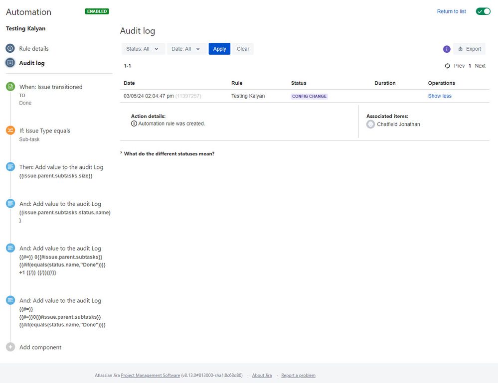

So, looks like you dont have lookupIssues. Which is fine. I am going to list you alternative steps. Can you replicate them and run the rule by transitioning a sub-task and sharing the audit log.
  • Log Statement = {{issue.parent.subtasks.size}}
  • Log Statement = {{#=}} 0{{#issue.parent.subtasks}}{{#if(equals(status.name,"Done"))}} +1 {{/}}{{/}}{{/}}
  • Log Statement = {{#=}}{{#=}}0{{#issue.parent.subtasks}}{{#if(equals(status.name,"Done"))}} +1 {{/}}{{/}}{{/}} / {{issue.parent.subtasks.size}} *100{{/}}
As mentioned, implement the rule like I have in below and share screenshot with audit log. Once done, we can continue with the If/Branch logic I mentioned.
Like # people like this

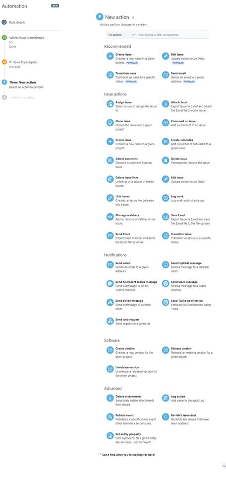

Jonathan Chatfield
May 3, 2024
I am on config change status still. I have made a change to a subtask status from done to To Do and back to Done. I do not see like yours where it says the status on the rule is success.

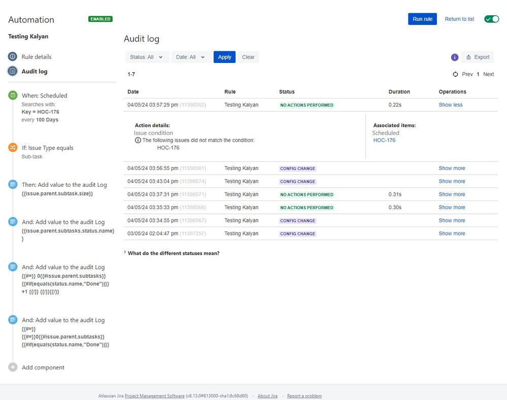

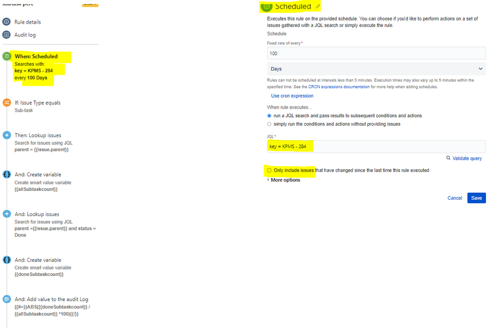

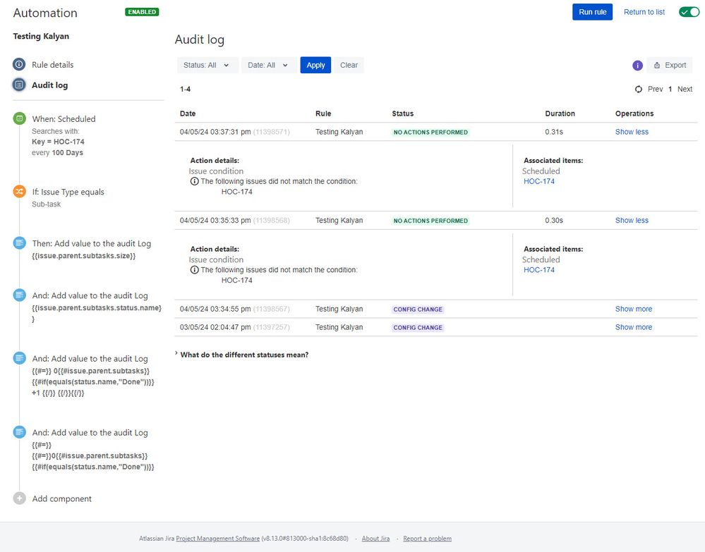

Lets try a different thing just to confirm rule is going to get triggered.
Change your trigger from "Issue Transitioned" to "Scheduled Trigger" and in the JQL section on same screen, give a sub-task key which we will use to test. Like I have below screenshot. Notice the highlighted section, make yours like I have..
So change trigger, go to that sub-task and change it from In Progress to Done  and share the audit log.

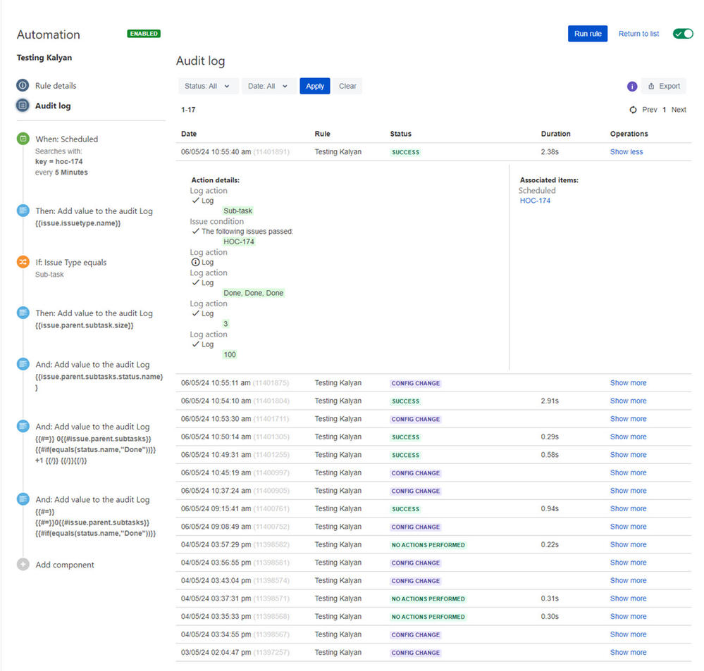

Jonathan Chatfield
May 4, 2024
@Kalyan Sattaluri I have did what you asked and highlighted shows that it is pulling from that subtask and added the logs, I had changed the status twice from in progress back to done and ran it to show the same function happening.
Your screenshot had the previous rule running that I do not have lookup functionality. I just wanted to remind you since we got so many screenshots haha! I do really appreciate you helping me and sticking with this. This is very kind of you!
Kalyan Sattaluri
May 4, 2024
Is HOC-174 a sub-task? Cause from the audit log it does not look like it.
Please replace it with a sub-task and transition that sub-task.

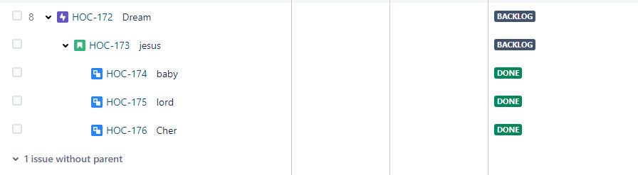

Jonathan Chatfield
May 4, 2024
It is a sub-task, I will change it to Cher hoc-176 and here is the log. I have changed the key to Cher then published it then went to hoc 176 cher then changed it to in progress to done then I pressed run rule button. I want to explain the steps I did to see if I did anything wrong! =D

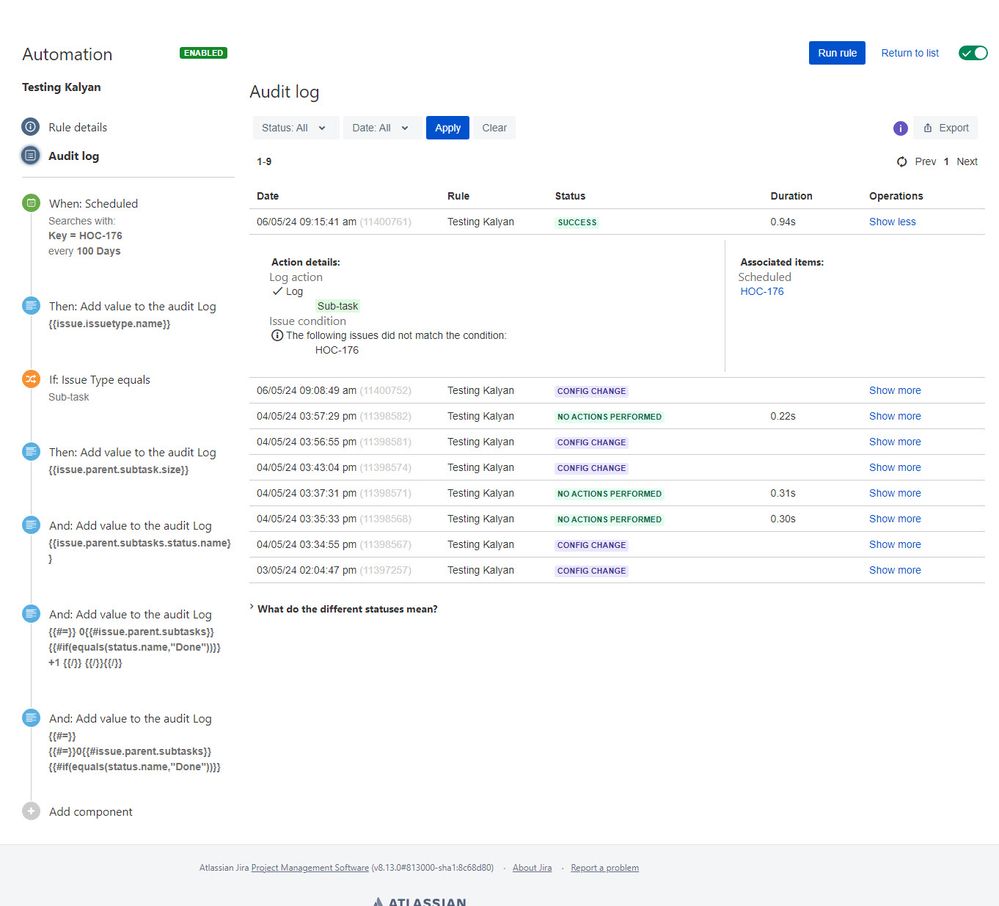

Hmm, something's strange. One last thing, can you, before the If condition, add another log statement to check if HOC-176 is called sub-task or something different in your set up?
So, log {{issue.issuetype.name}} like I have in my screenshot, right after the trigger, run the rule and share screenshot..
Like Bill Sheboy likes this
Jonathan Chatfield
May 6, 2024
Hey @Kalyan Sattaluri !
So I got a screenshot with a success but tell me if it looks good. I see a issue condition that does not recognize hoc-176. I hope we are making progress! =D
Kalyan Sattaluri
May 6, 2024
Hello @Jonathan Chatfield
I honestly am not sure why your "If condition" is not passing the check.
You may need to check with someone in your company on why thats happening as what I was sharing is expected behavior.
Either you are in a really old version of automation with bugs in software or there is something wrong with how your issue types are configured.
So please try to check in with someone in your company and share them this rule and ask why we cant get past the first If check.

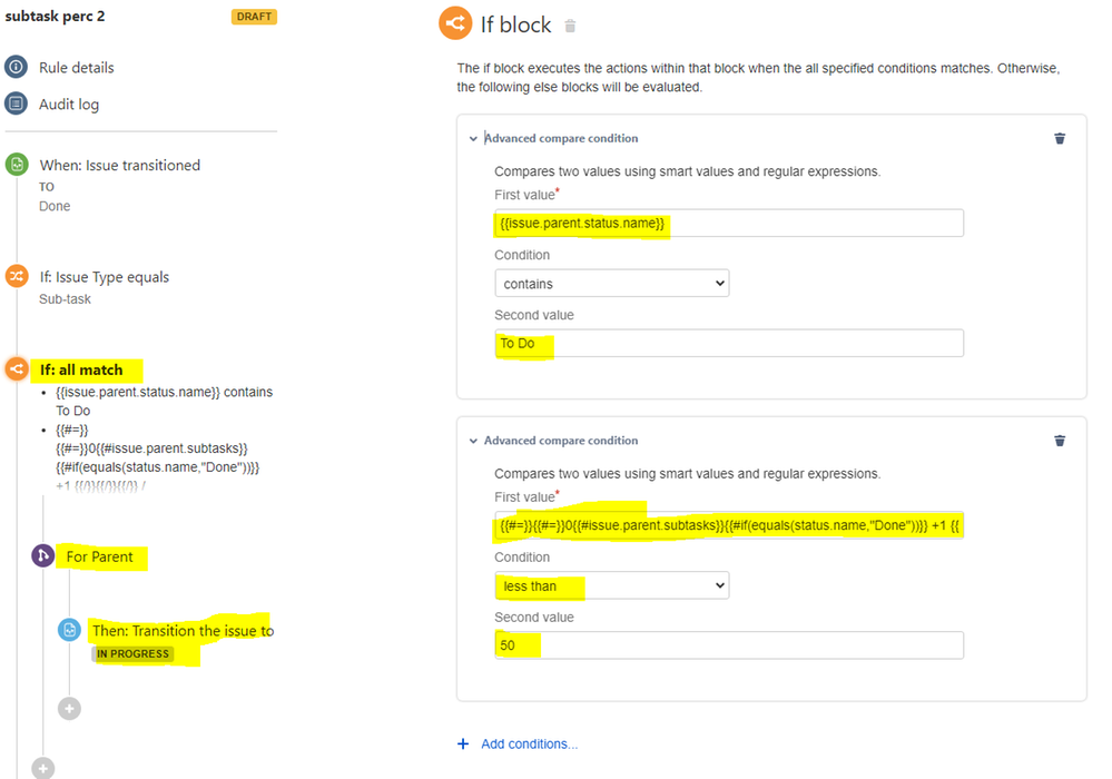

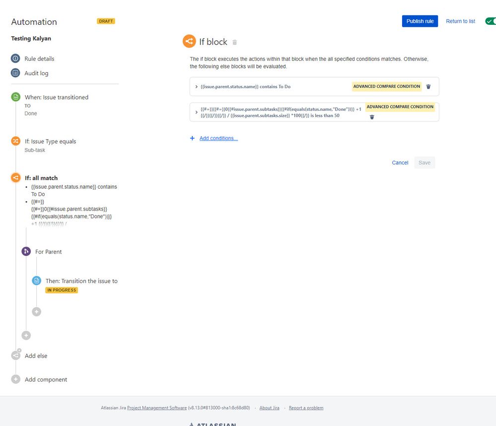

Jonathan Chatfield
May 6, 2024

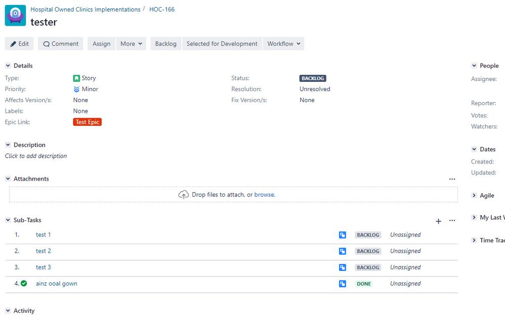

I feel like I typed everything like you did but there is something wrong with my If since I see the If block is saying did not match condition. Here is the code that I wrote:
{{issue.parent.status.name}}
Contains
To Do
Less than
50
Am I doing something wrong? Also I am attaching the main story screenshot as well just to show that I did 25%iverview.jpg

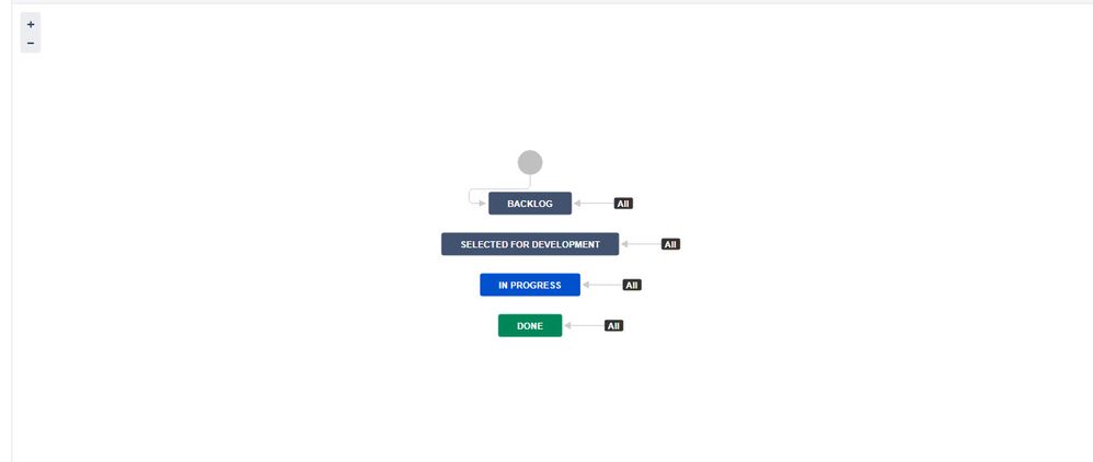

Kalyan Sattaluri
May 6, 2024
Your HOC-166 story initial state is "BACKLOG".
 so change first If condition to:
  • {{issue.parent.status.name}}
    Contains
    BACKLOG
Earlier it was To Do, because thats what I have as my initial state of story. So please take care of your status's names.
Jonathan Chatfield
May 7, 2024
Awesome, It works! Thank you for all this help @Kalyan Sattaluri
 I had to type Backlog and boom it all worked! I did a 50 percent In Progress and a 100 percent transition to Done status for the story!

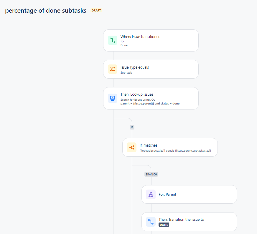

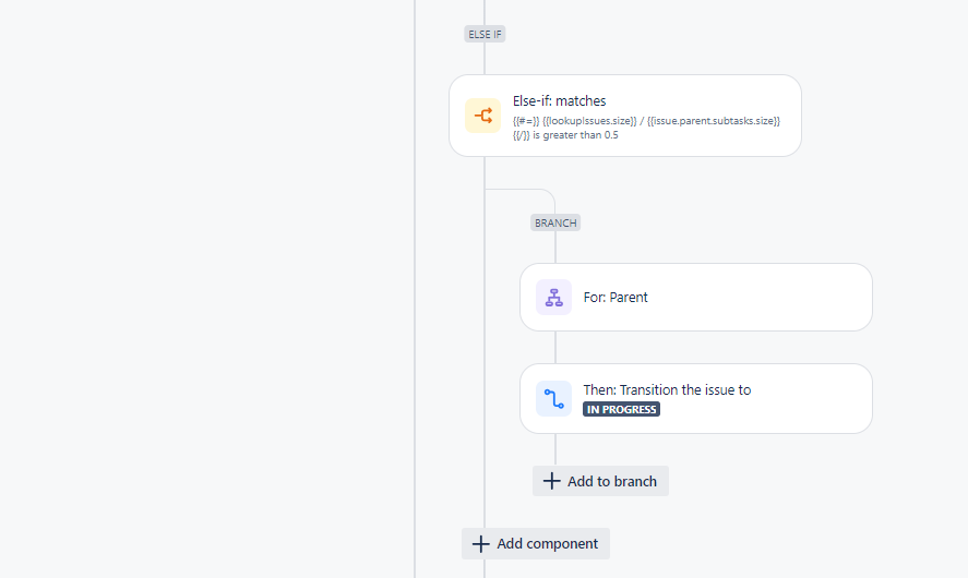

Stefan Salzl
May 3, 2024
Hi @Jonathan Chatfield - welcome to the community,
I suggest the following:
whenever a subtask is set to done the rule should run and check for all subtasks in the story. This will be done with a lookupIssues (collect all done subtasks within the same parent).
then going through the options with if-else conditions calculating the percentage of done subtasks and transitioning the parent via parent-branch.
see the screenshot below (I just took the status I have in my system - need to be changed according your requirements):
Hope this was helpful. Let me know if you have any further questions.
Best
Stefan
