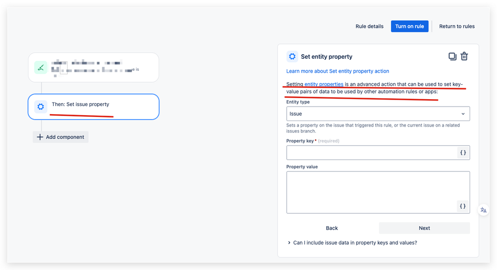

I understand, but is there a way to store non sensitive data in automation rules?

Darryl Lee
June 12, 2024
Yep, Issue Properties, Project Properties, these are all fine places to store non-sensitive data.
But IF YOU ARE TEMPTED to put an OAuth token in there, you should be aware that any user who has view access on the issue or project, can view all associated properties via the REST API.
Examples:
https://YOURSITE.atlassian.net/rest/api/3/issue/BUG-6/properties
https://YOURSITE.atlassian.net/rest/api/3/project/BUG/properties
So again, you do not want to store anything like an Oauth token there, because it is definitely NOT protected.
