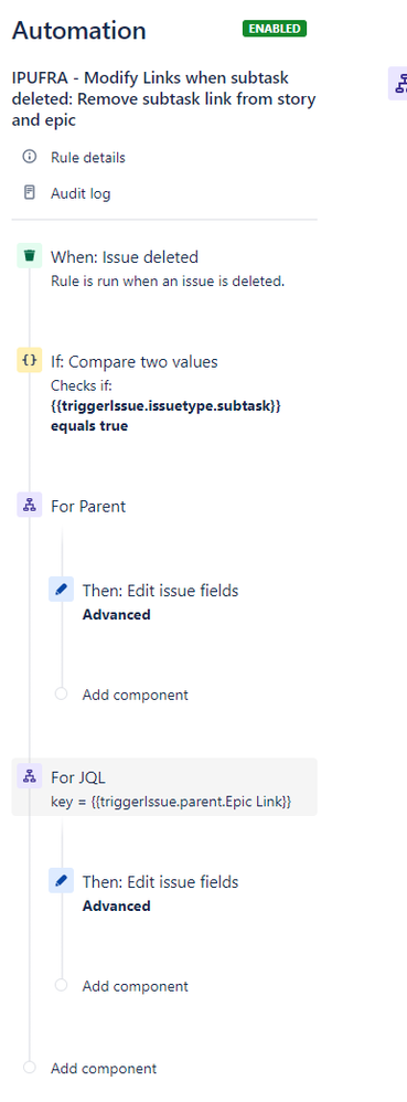

I am dealing with a strange limitation of JIRA automation. Here is the simple rule:
I try to reach the epic issue of a subtask by using a JQL branching. When using this on a "issue created" trigger, all works well. But when, in this case, I use it in a "issue deleted" trigger, here is what I get:
Error searching for related issues. This is most likely because the following issues don't have a related issue of the type you specified. Try narrowing your search to only include issues that contain links to related issues:
IPUFRA-220: "((key = IPUFRA-96) AND (key != IPUFRA-220)) AND (project in (10034))" - An issue with key 'IPUFRA-220' does not exist for field 'key'.
The JQL is not working because of the clause (key != IPUFRA-220) which seems to be added automatically. But for this trigger, this will always results in this error! This clause is not necessary. Any workaround with this?

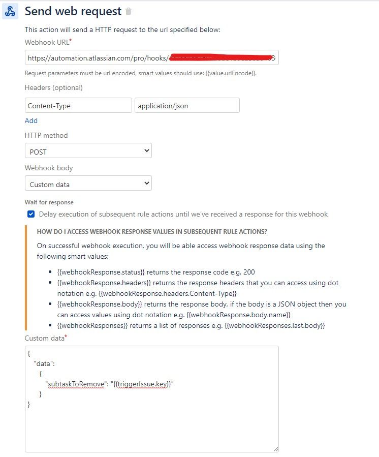

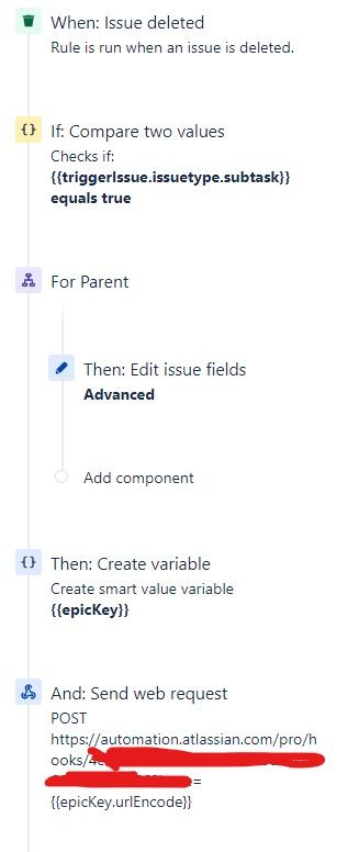

You have to send un web post request like this:
Where the body is defined as

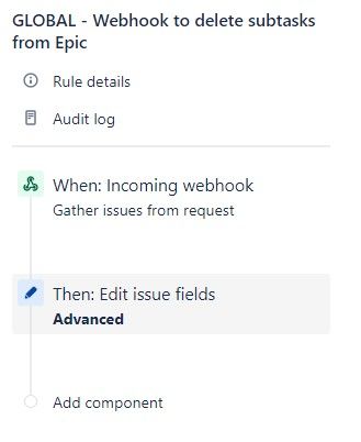

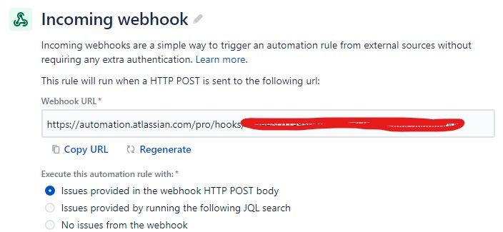

After that, you create another rule to catch the post request, like this:
Where the webhook is defined as:

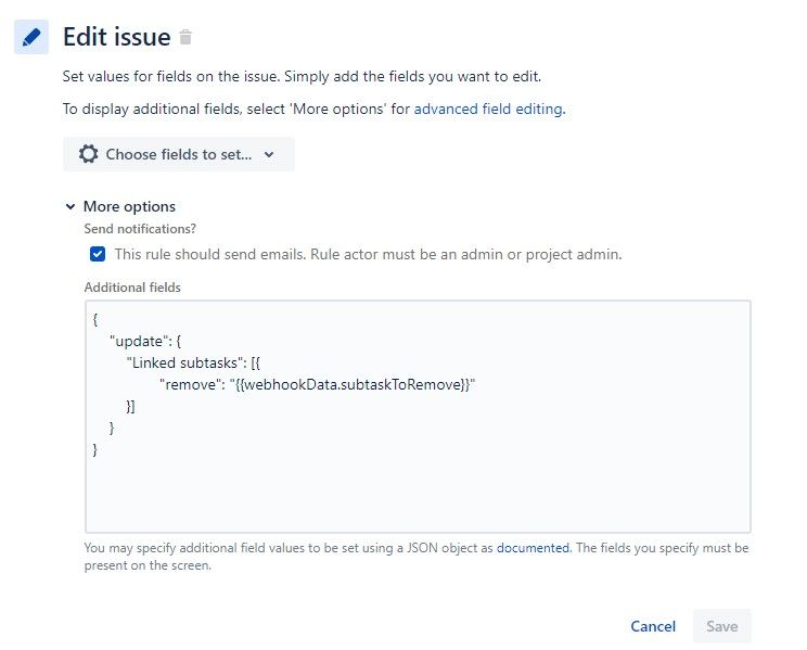

And then, you can do this:
