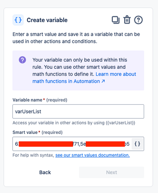

I created a Variable in the Automation rule to create a comma separated list of Account IDs.

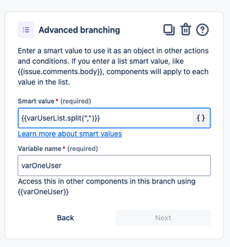

I'm using a Smart Value branch to iterate over that Variable.

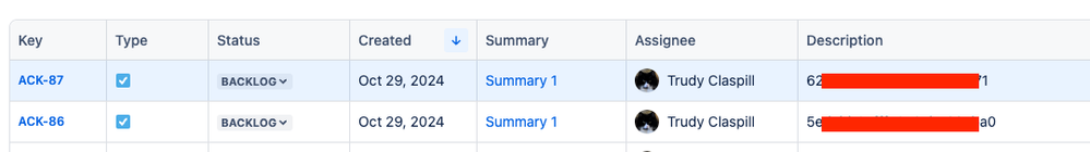

The problem is that the Assignee is not changing from one iteration of the branch to the next. All created issues end up with the same Assignee.

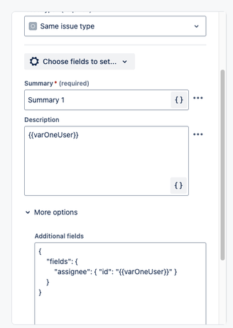

I have tried setting the Assignee by selecting the Assignee field to set and setting it to the branch smart value, and by using JSON in the Advanced Editing option.

I have tried swapping the order of the IDs in the Variable. In both cases the user is set to user 53...a0, regardless of whether it is first or second in the variable.

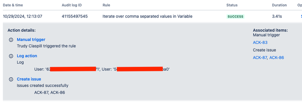

I am writing the branch variable into the Description field also so that I can confirm which value is in focus of the branch when the issue is created.
I have checked the History entries for the issues. The Assignee is not being modified after the Creation is completed.

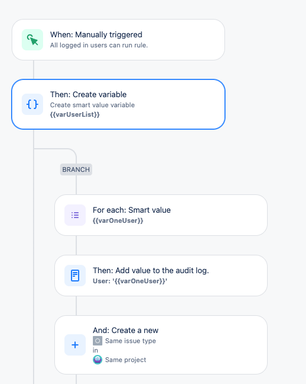

Below is my rule, details of the steps, and the output of the rule execution.
Any idea why the Assignee is not being set as expected? Thanks in advance!

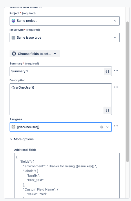

I updated the Create Issue action to remove the JSON and set the Assignee field directly with a Smart value.
The JSON shown is just the default text shown when you open that dialog and haven't entered your own code yet.
I ran the rule again and the result was the same; all issues assigned to the 53...a0 user though the Description field shows a different account ID for one of the issues.
I recreated the rule from scratch. Same result on the new rule.
When you tried to recreate this, did you enter your comma separated values directly in the Create Variable action? I notice that it says that a smart value is supposed to be used. I'm not sure that I've ever tried to directly enter a value for the variable rather than referring to a smart value elsewhere that held the value.

Hmmm...your audit log clearly shows there are no leading / trailing spaces for the values that could break the assignment.
If you look at the issue history for the created issues, is anything else perhaps re-assigning the issues?
