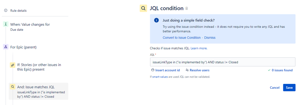

Thanks for the response @Curt Holley
You are correct for a single link i.e. a story linked in an epic your solution would work.
However, in my case Im looking for issues in epic with that epic linked to another epic.
the problem was with the jql string I was creating was having issues getting the correct escapes in place to manage the quotes and brackets.  So when I ran the query it failed.
I was able to solve this by using the string quoting of '/'.
I ended up with this and it is now working just fine:

Curt Holley
April 13, 2021
HI
I'm only familiar with the Cloud version of Automation, but ignoring my trigger/insert whatever trigger is relevant....wouldn't something like this work? plus no scriptrunner functions required.
