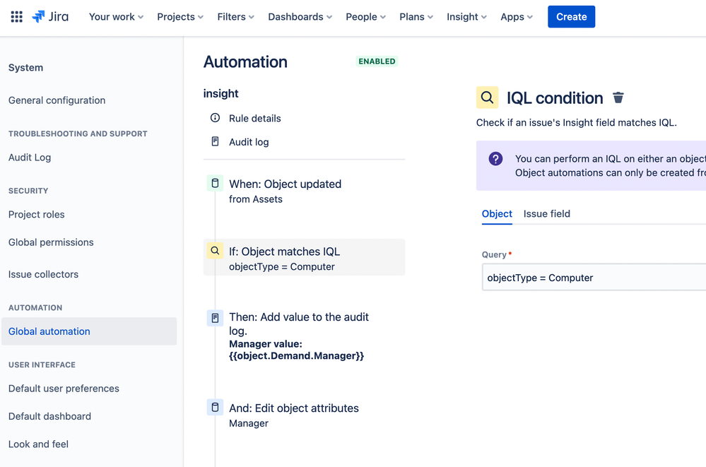

You need to use global automation rule to achieve this. I just tested it and following rules work for me:
Screen Shot 2022-01-27 at 22.54.43.pngScreen Shot 2022-01-27 at 22.55.00.png
Let me know if you need more help :)

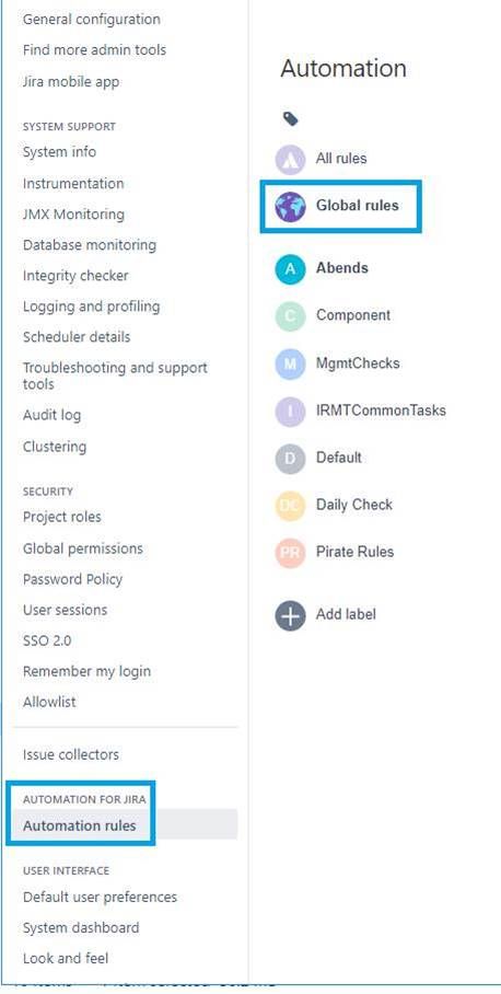

Thanks so much for the reply, although I have some differences in my options available. For a start, I don't have the "Global Automation" in the menu on the left like you do, I simply have Automation Rules and then an option to select Global Rules and create a new one:

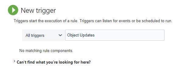

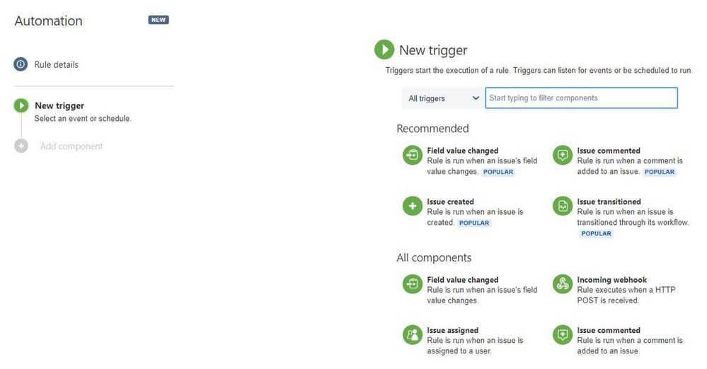

Then when I create a new rule, I don't have the "Object updated" trigger, they all seem to be issue related as opposed to Insight objects:
