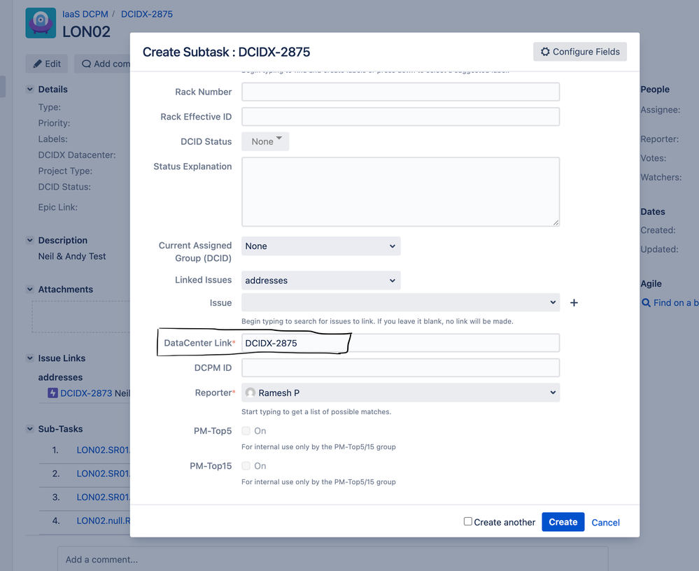

Could someone please help me to do on the JIRA cloud using Behaviours or with any alternative way, how can I auto-fill the 'DataCenter Link' custom field value  with the parent issue ID on the sub-task screen (where the issue type is 'Rack Subtask') like uploaded imageJIRA_DataCenter.png  but not after the sub-task is created?

I am able to populate the Datacentre Link field in the created sub-task using an automation rule,
but the requirement is that this field must also be mandatory on the sub-task creation screen. So they are expecting to fill the custom field value with the parent issue id in the create sub task  screen auto-fill is not working. Kindly help me to suggest is there any alternative way that I can achieve.

I have tried below script through Behaviours in ScriptRunner In JIRA cloud
getting the parentIssue.id and parentIssue.key but parent issue ID is not adding in sub task screen of the "DataCenter Link" field value
import com.atlassian.jira.component.ComponentAccessordef
targetField = getFieldByName("DataCenter Link")
def parentIdStr = getFieldById("parentIssueId")?.value?.toString()if (!targetField || !parentIdStr) returndef issueManager = ComponentAccessor.issueManager
def parentIssue = issueManager.getIssueObject(parentIdStr.toLong())if (parentIssue) {
    log.warn("Setting 'DataCenter Link' with issue ID: ${parentIssue.id}, key: ${parentIssue.key}")
    targetField.setFormValue([
        "key": parentIssue.key,
        "id": parentIssue.id.toString()
    targetField.setReadOnly(true)
Note: I am able to enter parent issue ID manually on "DataCenter Link" field textbox
