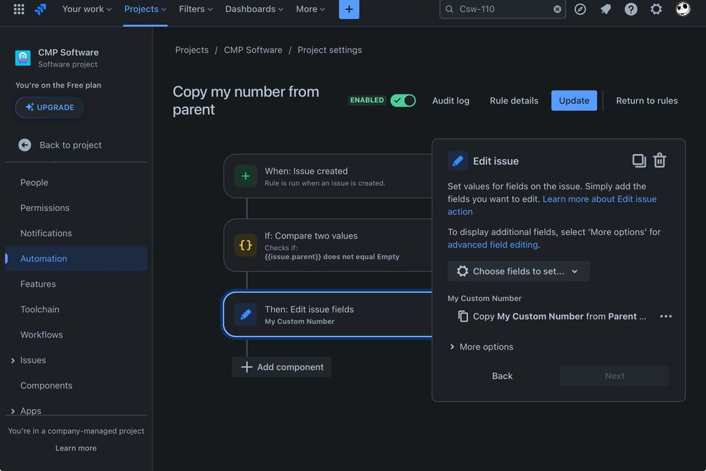

Jack Brickey
December 28, 2023
Try this...
obviously you will want to edit this to meet your exact needs. Basically what I present above is that when an issue is created, it simply checks to see if there is a parent and if so, it will continue and copy the custom number field from the parent to the current issue. you can add additional conditions to meet your specific needs. Let me know if I can assist further.
