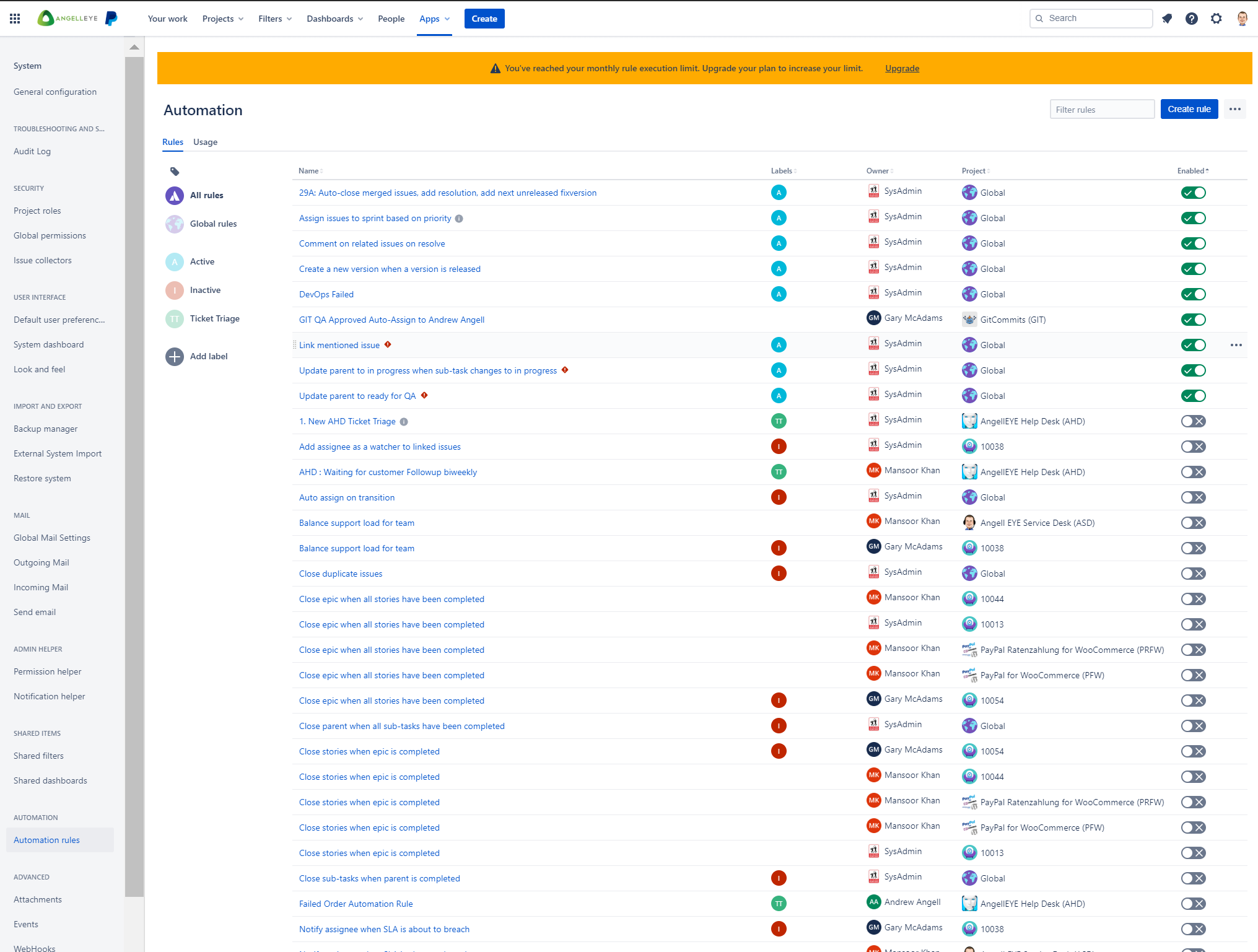

When I go to System -> Automation, I see this, which looks just like the screenshots in the plugin shown above:
However, most of these rules are disabled, some of the ones that are enabled are showing errors, and the notice at the top is showing that we've already maxed out our execution limit after only 3 days, so none of the rules are going to be running anyway.

John from the automation team here. It is a bit confusing I must confess. Automation for Jira was recently acquired and built natively into Jira Cloud. We are working on aligning the two automation engines so Jira automation (i.e your screenshot below) is the one true automation engine and everything will live in one place.
We ran a few webinars and these questions came up a lot. We documented them here: https://community.atlassian.com/t5/Jira-Software-articles/79-Questions-and-Answers-about-Jira-Automation/ba-p/1363930
