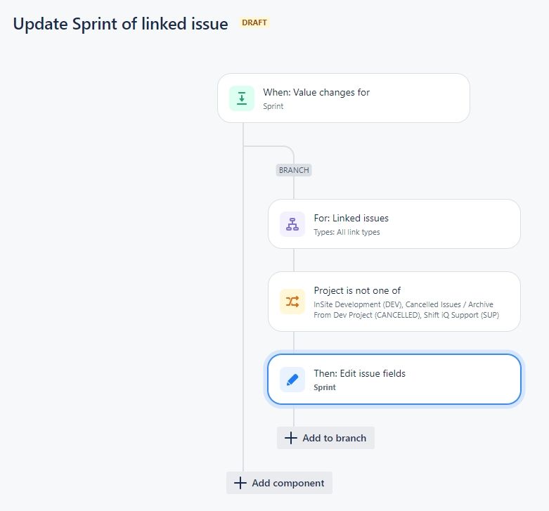

I'm trying to create a global automation rule that updates the sprint field in a company managed project whenever the sprint field of a linked issue in a Team Managed project is updated. Here is the automation I created, but it is not working. Does anyone have a solution?

Hi @Marsha Miller
Just looking at the rule sequence, this looks correct. Did you check the audit log of the rule for any errors? If this does not solve the problem, can you share a screenshot of the configuration of the "Edit issue fields" action with us?

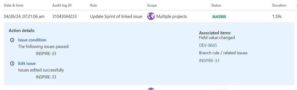

The rule thinks it’s working; the audit log shows success.
In the instance above, I changed the sprint of Dev-8665 with the expectation that the Sprint field of INSPIRE-33 would update. The audit log indicates that it did, but when I edit INSPIRE-33, nothing has changed.

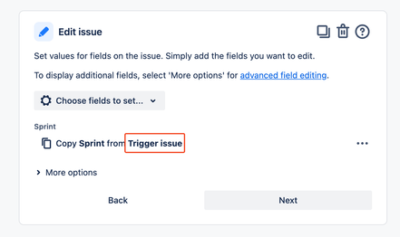

@Marsha Miller I see in your screenshot that your rule copies the sprint from the current issue. This means that the sprint basically gets copied from the linked issue to the linked issue, so nothing happens. This is because if you use current issue in a branch of a rule, you're referencing the current issue of the branch – and this is the linked issue in your case.
To solve this, you just have to choose "Trigger issue" in the action. This will copy the sprint value from the actual issue which triggered the rule:
