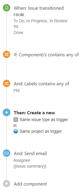

Creating an automation routine for the quarterly PM has been quite simplistic: triggered by an issue transitioning to a 'Done' status, and meeting other conditions, a new issue is created with the due date set for {{now.plusMonths(3)}}. This allows for the next-scheduled quarterly PM to regularly be created every 3 months from the completion of the previous PM.

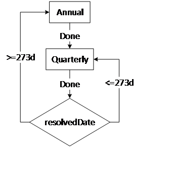

I was giving some more thought to the issue and I'm thinking the automation routine would have to resemble something like the workflow below; which may be more simplified than counting every 4th execution of an automation routine. Where the initially-created, triggering issue can be labeled as an Annual, upon completion, the created issue is labeled as a Quarterly with the {{now.plusMonths(3)}} due date assignment. Upon completion of an issue labeled as Quarterly, a conditional statement will check when the last issue labeled Annual was resolved. If greater than or equal to 9 months, then the next created issue is one labeled Annual. If less than or equal to 9 months, then another issue labeled Quarterly with the {{now.plusMonths(3)}} due date assignment is created. As I'm new to Jira automation, what's the cleanest way to locate the most-recent resolved issue featuring a specific label and compare it to a timeframe, such as 273 days?
