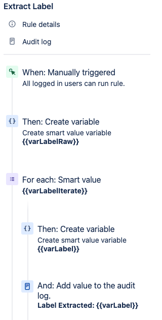

You could capture labels as a variable and branch off of that which is the route I took:
Here's further context:
varLabelRaw
{{issue.labels}}
varLabel
{{varLabelIterate.match("(abc\d+)")}}
 Again, there may be a way to do this without branching into the labels, but this is what worked for me.

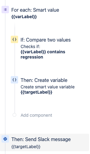

Thanks for the info! I think my situation is slightly different so I tried to take your advice and match it to what I'm trying to do. Based on your feedback I tried the following but was still unable to get it to work:
I created a foreach loop (set the smart value to {{issue.labels}} and gave it a variable name of varLabel).
Then I created an if statement that checked if varLabel contains a string.
Then if that succeeded I created a variable called targetLabel (Variable name is targetLabel and smart value is {{varLabel}}).
Then i tried to access {{targetLabel}} in my message body. However when I run this I dont get anything.
Do you know what I might be missing?

Mark Segall
March 29, 2022
I believe there is a limitation in Jira that variables created in a branch only exist within the branch, so you may need to move your slack action into the branch for it to read targetLabel.  If you still see nothing, I would add an audit log action right after your variable just to make sure it is in fact capturing something for targetLabel.
Axel Kerksiek
March 29, 2022
ah ok that worked, thanks for your feedback and help!
