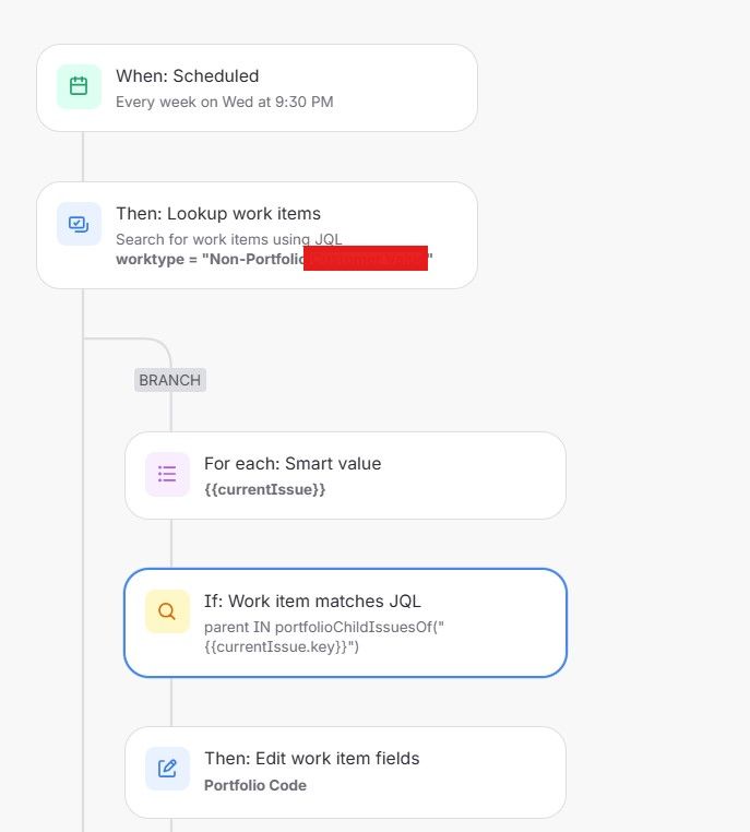

Based on a few examples, I built this so far but it does not work:

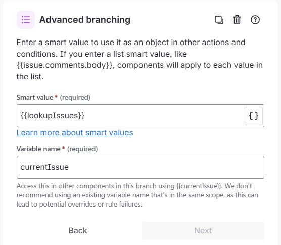

The advanced branching rule is

The JQL I use on the branch is
When I look at audit log, it does show success but when it gets to the JQL condition step, it says:
The following work items did not match the condition:
ABC-123, ABC-124
The work item didn't match the specified JQL.
The chosen rule actor doesn't have permissions (or work item security level permissions) to view the work item.
the work item was deleted or wasn't indexed by Jira yet (in rare circumstances)
We recommend using the 'Issue fields condition' for more consistent results.
Let me know thoughts if you can.
Also you said "Then set your branch to iterate over the results of the lookup." can you let me know how / where this is done on the branch?
Thanks again, appreciated

What if you just use {{currentIssue}} instead of {{currentIssue.key}}, as you varialbe name is currentIssue

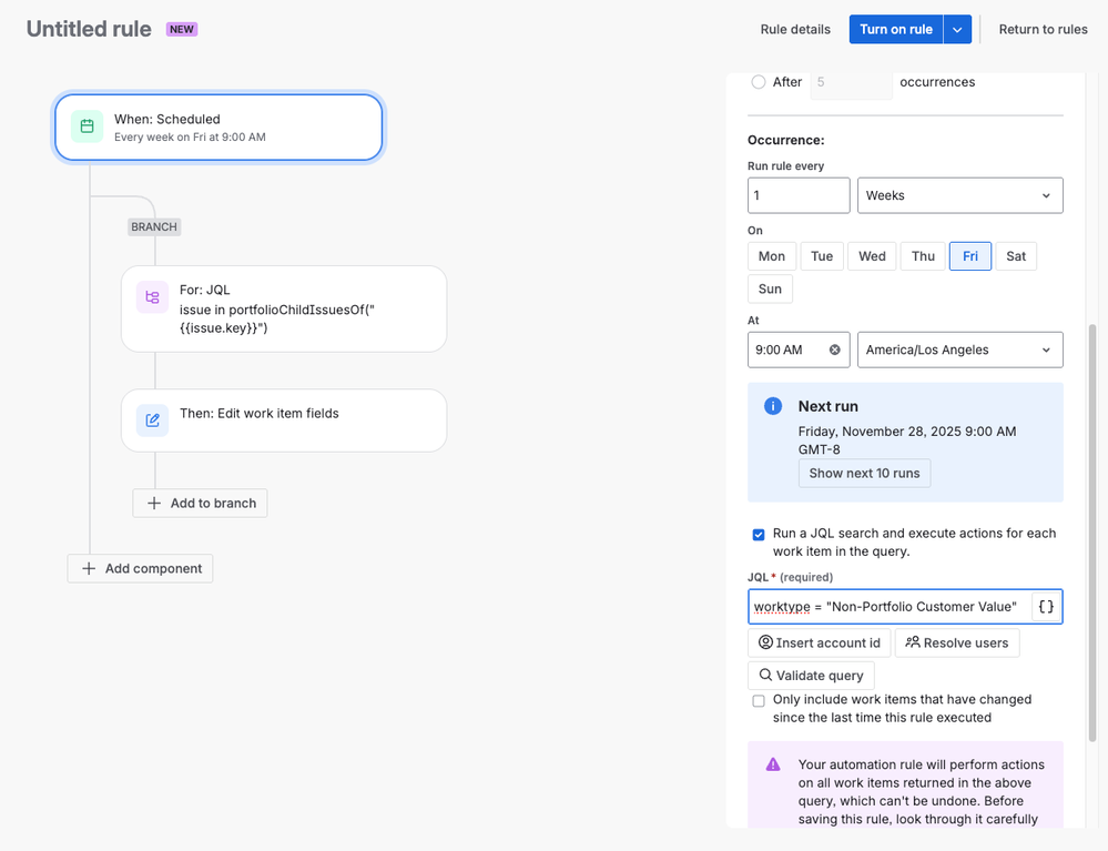

Hello @Matt_Rochman
Let me parrot this back and see if I have it correct.
In the scheduled trigger you are running a JQL that returns a set of issues; let's say ABC-123 and ABC-456.
In the rule you want to update all the child issues under those two, regardless of hierarchy level. You could get the child issues for each of them manually using the filter:
issue in portfolioChildIssuesOf("ABC-123")
issue in portfolioChildIssuesOf("ABC-456")

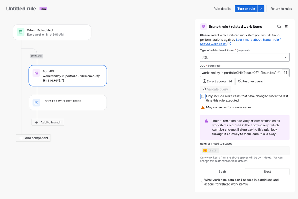

If I have understood that correctly, then you can accomplish that with a very simple rule:
The JQL in the schedule selects the "parent" issues.
The remainder of the rule will be run for each issue selected by the Schedule trigger.
So, add a For Each: Related Issues: JQL
Insert the JQL that will select all the child issues of a given issue, which according to the documentation is:
 workitemkey in portfolioChildworkitemsOf("work item key")
For this case the actual JQL is:
workitemkey in portfolioChildIssuesOf("{{issue.key}}")
That will get all the child items for the issues from the trigger, one trigger-issue at a time.
The remainder of the branch will be executed for each of those issues. So add an Edit action inside the branh.
