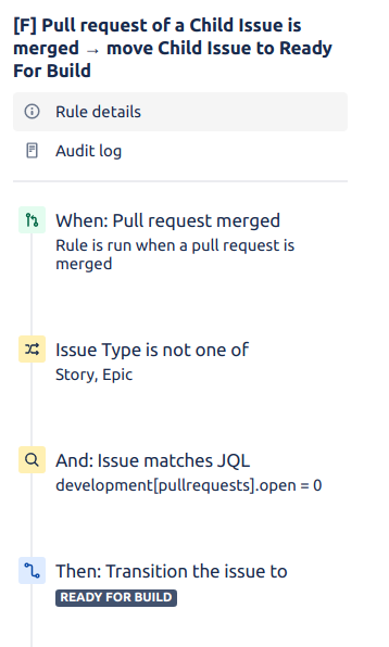

I've been using Jira automation rules and GitHub to track the development process on my team, and we've been struggling with this issue.

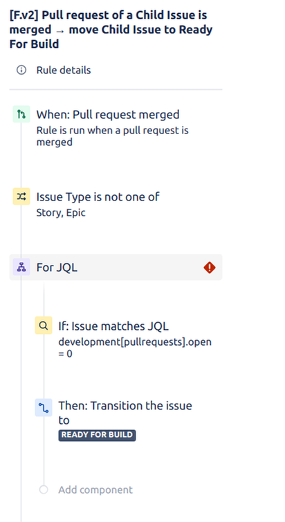

At the moment, we have a rule that works only when one issue is linked to one pull request (see below), writing the issue key on the title of the pull request. But my objective is to make a rule such that "When a pull request is merged, all the issues that are linked to that pull request transition to the status 'Ready For Build'", since sometimes multiple Jira issues/development issues are addressed on a single branch and then a single pull request is needed.
From the question "Update multiple issues, that are not linked, using Jira Automation" the solution seems to be using a branch action and a JQL query (see the second figure below). But the thing is that I've not been able to find a way to detect all the issues associated with the merged pull request using JQL. Is there a way to do this?

Hi @Ignacia -- Welcome to the Atlassian Community!
I note in your screen grab that there is an error icon by the JQL branch.  Did you define the JQL for the branch?  If not, you could probably move the JQL from the condition immediately below it to the branch, and then delete the condition.
Or, move it above as shown in this article which is quite similar to your use case:
https://www.atlassian.com/devops/automation-tutorials/jira-automation-rule-on-pullrequest-merge

Ignacia
October 21, 2021
Hello Bill! Yes, the error icon is because (for the purpose of taking the screenshot) I didn't add any JQL query haha. The main question is precisely how to make a query in that block that detects all the Jira issues associated with the merged pull request :)

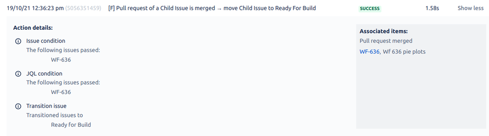

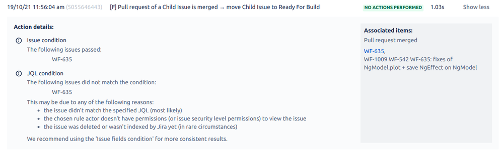

Yes, my understanding was also that the trigger would fire for each issue associated to the PR, but the main thing is that is not happening, and that's why I searched for another way of doing it. In this case, I found that maybe I could do it with a JQL, but I dont know how to access to "all Jira issues associated with the merged pull request"
To complement the comprehension of the problem, here's some audit logs for the rule [F] that I thought It will work, but It didn't: The Jira Issue WF-636 had only one Pull request associated, so it worked properly. But the Jira Issues WF-1009, WF-542 and WF-635 (that where associated  all to one pull request), didn't worked. The rule developmen[pullrequests].open = 0 was true for all of them.
PS: I added only the audit log for the Jira Issue WF-635, but for WF-1009 and WF-542 the image is the same. image.pngimage.png
