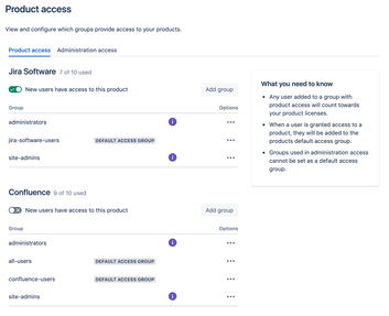

Hey @Jeshua - ah yeah, so Confluence Access is gated by groups listed under "Product Access" for your site, so assuming those are not managed groups (connected to your IdP), then your method is correct.
default_product_access
(So if you're removing user from all-users and confluence-users) that should remove their Confluence access.)

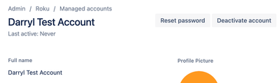

You can use this API to programmatically click the "Deactivate account" button, like here:
So I messed with this, and there's some very specific requirements:

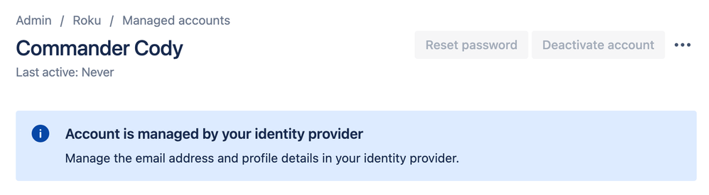

This is of limited use though, because if you've claimed your domain, most if not all of your accounts are probably Managed, so deactivation must happen in your IdP and you'll see this message:
The error message that comes back when I tried to deactivate that account with the API endpoint is:
{ "key":"forbidden.action",
"context":{"allowed":false,"reason":{
"key":"externalDirectory.scim"}
"errorKey":"forbidden.action",
"errorDetail":{
"allowed":false,"reason":{"key":"externalDirectory.scim"}
