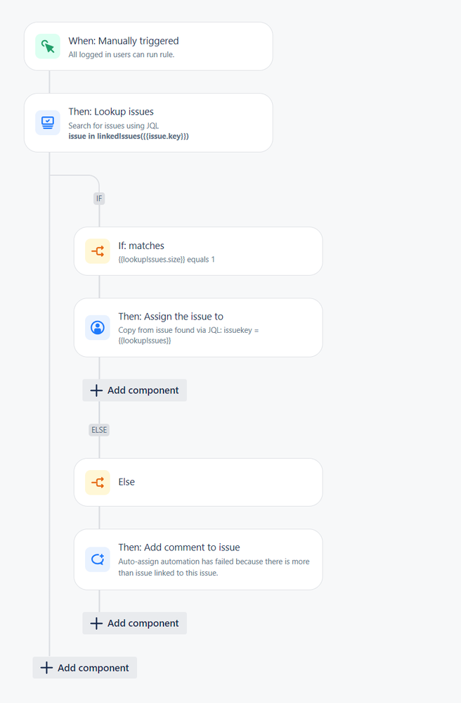

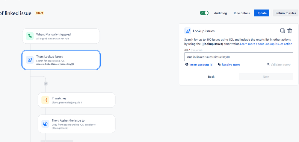

Diogo Teles
May 3, 2024
@Dmytro Shaforost I had a similar issue just now. Using @Bill Sheboy 's insight I was able to implement it. This is how I tested it (hene the manual trigger and lack of other conditions), you can adapt from it:
Like Jeroen Cornelis likes this
Jeroen Cornelis
November 22, 2024
Hi @Diogo Teles
This worked for me, thank you! But is there a way to let this automation run automatically instead of via manual trigger?
When an issue is created and afterwards gets assigned to somebody I need the assignee to be copie to the trigger issue automatically.
Thanks in advance!
