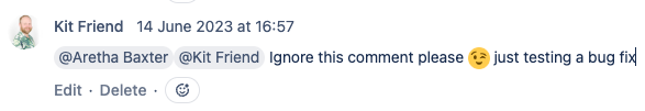

Kit Friend
June 14, 2023
@Bill Sheboy  I've been getting a (low number of) persistent errors where if multiple mentions are on the same text line without spaces or any punctuation between them, the amended rule fails. Did this come up in your testing?
i.e. this works fine:
but this fails:
Bill Sheboy
June 15, 2023
Hi @Kit Friend
No, I had not tried that scenario...and it failed for me also.  I had to explicitly delete the space after the first mention to create this condition.
One work-around is to always ensure there is a space before the mention text and then split:
{{issue.comments.last.body.replace("[~accountid"," [~accountid").split(" ").match("(accountid:.*)]").remove("accountid:")}}
I will update my earlier answer to include this also.

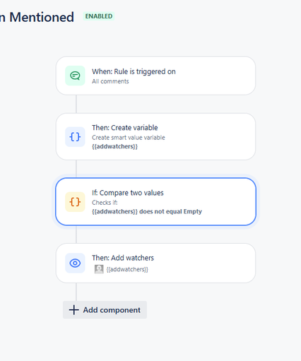

Hey @Bill Sheboy  Im using this code now:
{{issue.comments.last.body.split(" ").match("(accountid:.*)]").remove("accountid:")}}
and when I tag multiple users its doesn't make them watcher, only when I tag only one.
do you know what i need to change in the code or in the automation that it will fix it?

Bill Sheboy
January 6, 2025
Hi @Omri Zeman
Please see my response to your own question on this scenario as it requires using an advanced branch:
https://community.atlassian.com/t5/Jira-questions/Re-Auto-Add-Watchers-When-Mentioned-in-the-comment-problem/qaq-p/2908107/comment-id/1078651#M1078651
