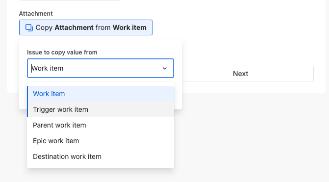

Hello @ciriloh
Can you confirm that what you want to copy is an attachment (a PDF created when the form is submitted) versus the Form itself?
Can you provide us with a screen image of the entire rule you have constructed so far?
Assuming the first answer is "yes, an attached pdf" then I believe you would need to update your Clone (or Create) action to include the Attachment field, and set it to copy the attachments from the trigger item.
You may need to have some sort of delay between the trigger (original issue created) and the steps where you duplicate the issue, so that there is time for the Form to be saved as a PDF attachment on the original issue. The Delay action, though, is available only in Premium and Enterprise subscriptions.

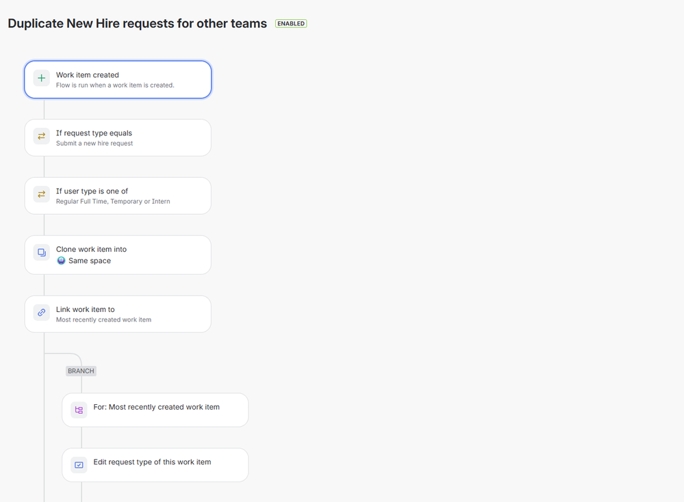

Yes, I want a copy of the attachment that is included when the form is submitted.   I kind of inherited this automation flow.  As far as I can tell, the automation looks for a new work item created, then verifies if it has a specific request type (in this case:  Submit a New Hire Request),  verifies the user type (Regular Full Time, Temporary or Intern) then  clones any requests that meets that criteria and links it to the original work item.   Jira Automation.png

Ok going to try this next.  I added a 90 second delay in between the "if the user type is one of" validation step right before the clone.   Based on the audit logs it takes roughly a minute to create the PDF.  Then I updated the clone to add the attachment to copy from the trigger work item as suggested.
Logically it makes sense.  It allows the automation enough time to create the PDF attachment, then to be able to grab the attachment and move forward.   Here's hoping!
Like Trudy Claspill likes this
ciriloh
May 22, 2026
Tested it and so far it works!   Thanks!

This answer concerns cloning the form itself and the content of the form.
If the form has been saved also as a PDF to the original issue (shown as disabled below) then you can copy the attachment to other issues.
ciriloh
May 13, 2026
Ok that option was disabled on our end.  I enabled it and we'll give it a try and see.  Thanks!
