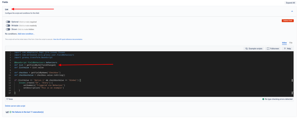

1. Server-Side behaviour code for the List:-
import com.adaptavist.hapi.jira.issues.Issues
import com.onresolve.jira.groovy.user.FieldBehaviours
import groovy.transform.BaseScript
@BaseScript FieldBehaviours behaviours
def list = getFieldById(fieldChanged)
def listValue = list.value
def checkbox = getFieldByName('Checkbox')
def checkboxValue = checkbox.value.toString()
if (listValue == 'Option 1' && checkboxValue == 'Global') {
Issues.create('EX', 'Story') {
setSummary('Triggered via Behaviour')
setDescription('This is an example')
Below is a screenshot of the Server-Side Behaviour configuration for the List:-

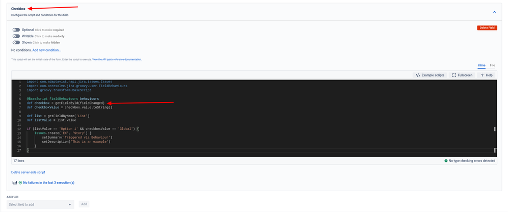

2. Server-Side Behaviour code for the Checkbox:-
def checkbox = getFieldById(fieldChanged)
def list = getFieldByName('List')
Below is a screenshot of the Server-Side Behaviour configuration for the Checkbox:-

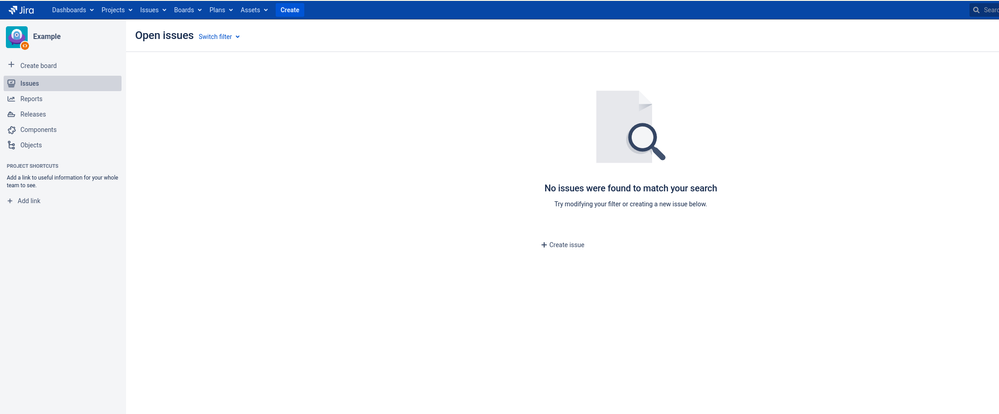

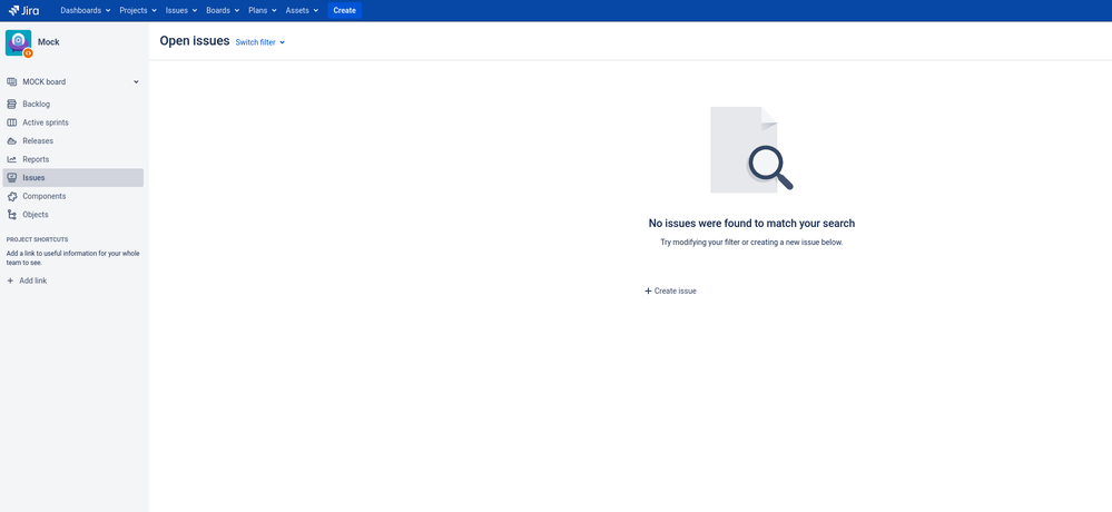

1. When the is started, both the Mock and Example projects are empty without any issues, as shown in the screenshots below:-

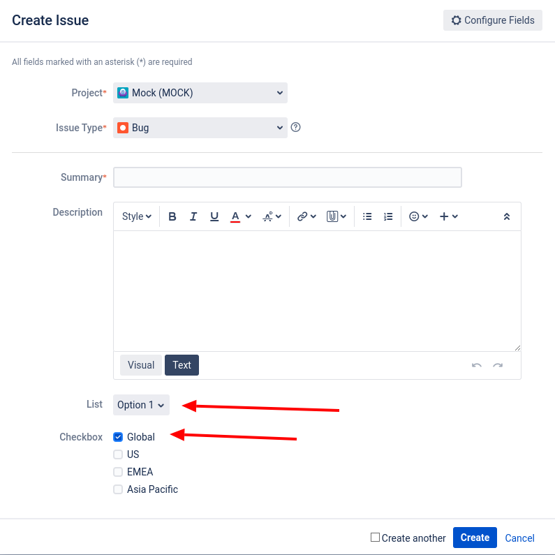

2. Next, I am going to try and trigger the Behaviour on the Create screen of the Mock project as shown in the screenshot below:-

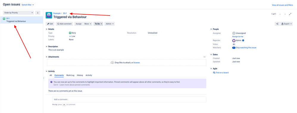

4. When Option 1 is selected from the List and the Global option is selected from the Checkbox, as expect,ted a new issue is created in the Example project as shown in the screenshot below:-
