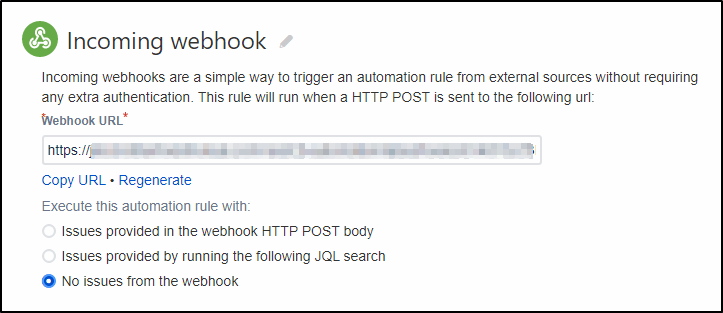

My Situation:
I have an Automation with an Incoming webhook trigger set-up. I'm receiving form-data from Cognito forms and creating new Jira issues, populating fields using the webhook form content.
This works great, but I can't find a way to attach the attachments coming in from Cognito on the webhook.
I can see/log the attachment information:
I can parse the file data:
Note: The above links don't work here for obvious reasons.

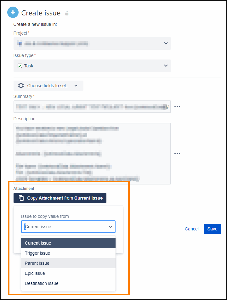

  1. I select "Attachment" in the "Choose fields to set..."
  2. Then I see only "Copy value from" -- but nothing related to the webhook.
Is there a way to save attachments coming into the webhook?

Hi @Mark B Wager
I'm afraid that this isn't possible at the moment.
Cheers,
Simeon.

February 18, 2021
Hey @Mark B Wager
I'm afraid it isn't possible with Automation to get the attachment from the incoming webhook and attach it to an issue. I'd definitely try exploring the email sending approach. You can act on issues created that way with Automation.
Cheers,
Simeon.
