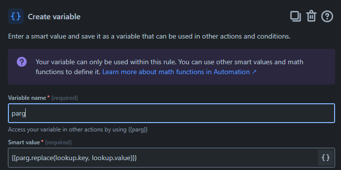

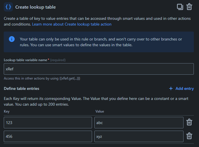

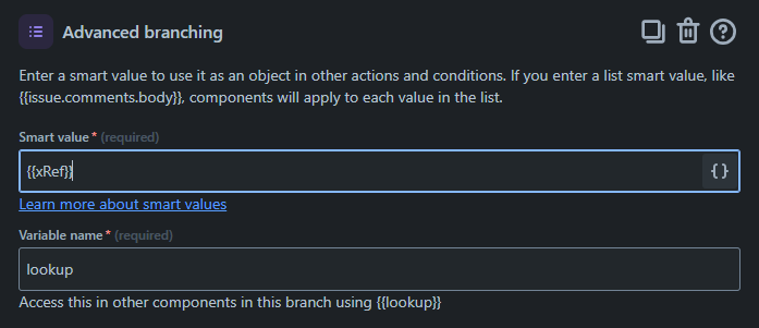

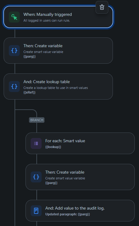

I'm trying to build an automation to will replace text within a user defined text field (could be in Jira or Confluence) by looping through a lookup table (with key value pairs) with an advanced branch.
I have not been able to figure it out yet through I did try some variations per the explanations below:

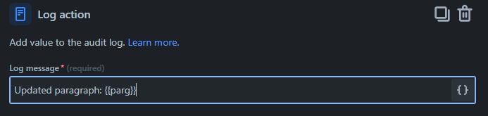

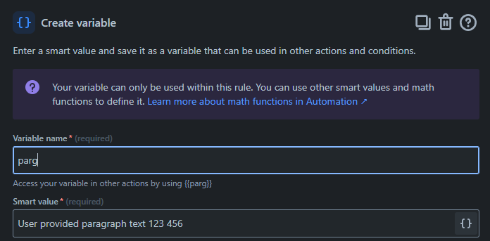

The following screenshots are a simplified version of what I'm attempting to do (my text field and lookup table would be much larger)
The desired outcome in the above would be that 123 and 456 are replaced with abc and xyz .

What you are trying to do with the advanced branch to "update" the variable cannot work that way.
Branches which could be on more than one thing / issue (e.g., advanced branch) are executed in parallel and asynchronously, and so each pass through the loop is independent.  There is no guarantee of when such branches will finish up until the last step in the rule, and so it is likely the branch is still running when the steps after the branch process.  Thus your re-created variable just repeatedly goes out of scope and vanishes.  ( There is an open suggestion to add an option for sequential versus parallel processing of branches / rules: https://jira.atlassian.com/browse/AUTO-32 )
There are elaborate workarounds to perform sequential processing for rules using webhooks to repeatedly callback themselves.  These have limitations and risks, and may not be a good fit for multiple find / replacement of text.

I recommend avoiding using variable names which could be confused (by a person or rule) with an existing thing, such as lookup.  I normally do this by adding a prefix, such a var for variables and tbl for tables.  And so your lookup one could be renamed varLookup.
If you review that updated article on Lookup Tables, you will find the entries function / attribute, which returns the table as a list of rows.  For your advanced branch, that smart value expression would be:
{{xRef.entries}}
Although due to the reasons noted earlier, that would not help solve the update scenario.
