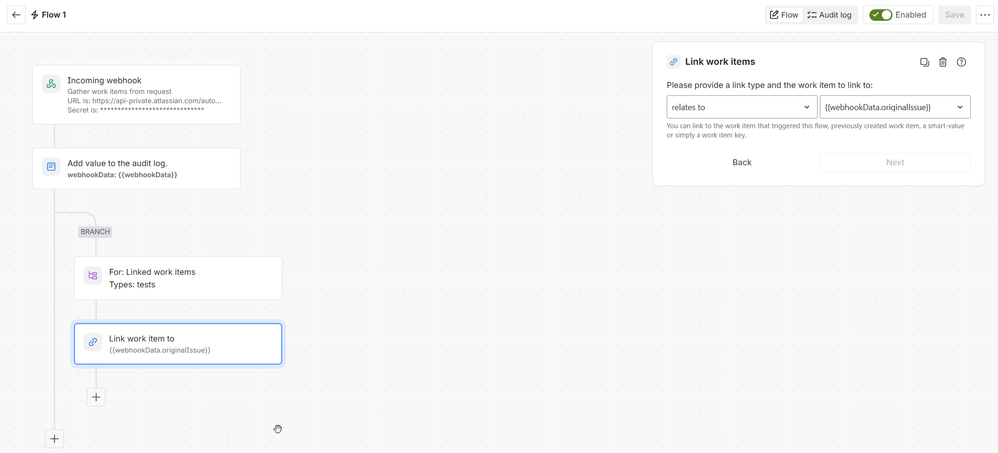

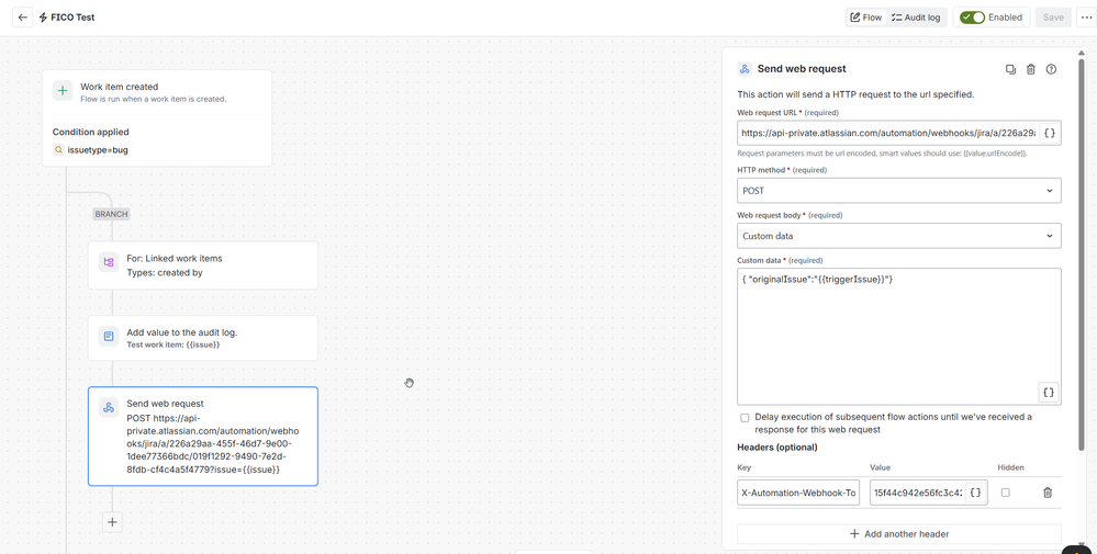

Fabian Weber
July 1, 2026
Resolution acquired!
After a lot of configuration changes and testing we got a solution – thanks a lot for the support, especially @Rudy Holtkamp !
The key points that made the automation work:
  • Use the correct link types consistently across your branches:
    • Bug → Test: created by
    • Test → MIGObject: tests
  • Ensure that your branch configuration matches your desired exact link types, otherwise related issues won’t be found.
  • Pass the originating issue correctly via the webhook using:
    ?issue={{issue}}
    This was essential to transfer the context between the two automation rules.
  • Use a two-step automation approach:
    1. First rule: Trigger on Bug creation → call webhook
    2. Second rule: Receive webhook → traverse linked Test issues → link corresponding MIGObjects back to the Bug
Result:
When creating a Bug and linking it to a Test, all MIGObjects linked to that Test are automatically linked to the Bug as well.
Here are some Screenshots of the two Automations for a better understanding:
Automation 1:
Automation 2:Automation 1.png
💡 Maybe this helps someone facing a similar setup with cross-linked issue structures and webhooks.

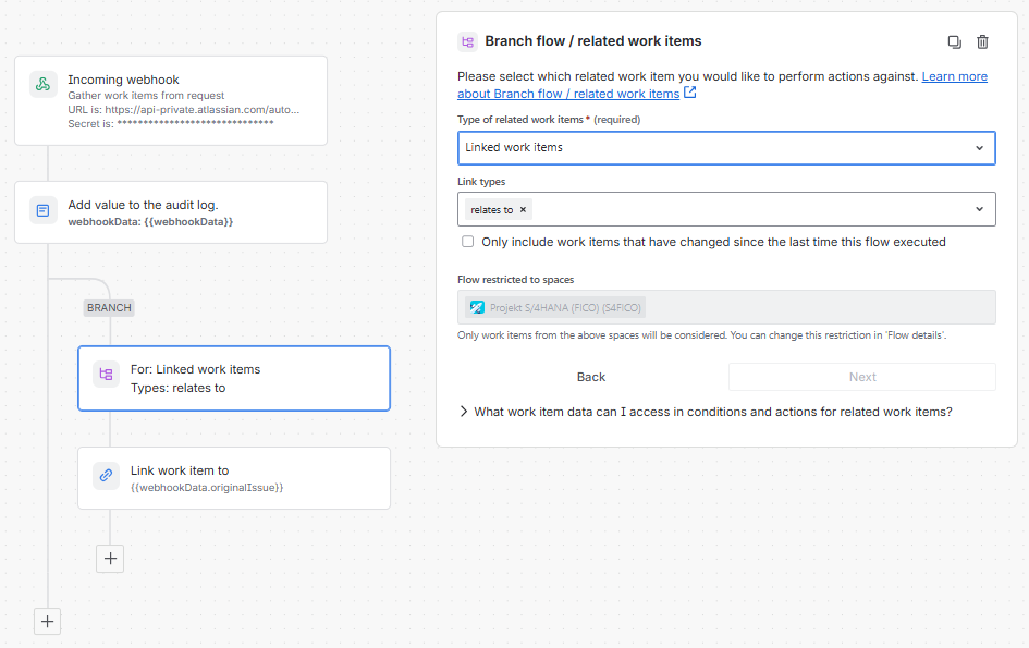

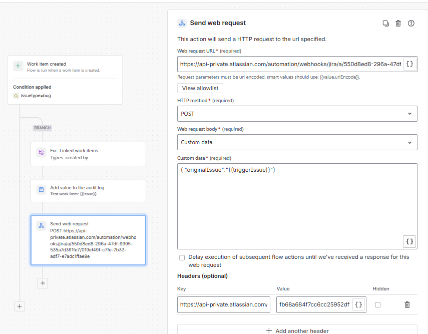

Fabian Weber
June 23, 2026
Hello Rudy,
thanks a lot for your dedication and quick answer!
I think I already implemented the two automations so far.
Is this how you thought of the result?
Fabian Weber
June 23, 2026
fyi: When you said "Use X-Automation-Webhook-Token as the header key" - where did you find the token exactly?
I just used the webhook url for it. Please correct me if there is a better solution. :)

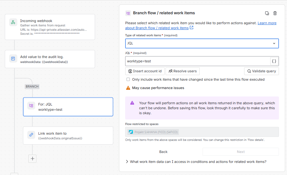

Rudy Holtkamp
June 23, 2026
Hi @Fabian Weber ,
For the first picture the branch should also be a 'For linked work items' not a branch on JQL. The rest looks like I intended.
Rudy Holtkamp
June 23, 2026
Ah wait, at the header key should be the word: X-Automation-Webhook-Token
And the value is the thing you paste from the other flow.

Fabian Weber
June 23, 2026
Hi @Rudy Holtkamp ,
so far it is not possible to include the link type "test" directly:
If I wanted to, I could use it as a condition. But if it is working like that, I'd be happy.
