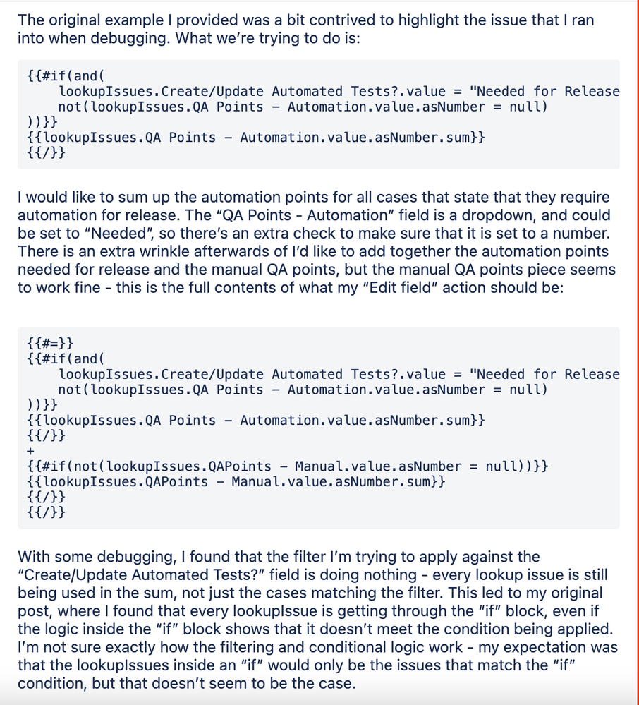

Lana Laureano
January 24, 2023
I'm not sure why but I tried to respond and my message got blocked with "You may have recently posted the same thing elsewhere on the community. Update your text, or wait before reposting."
Hope this doesn't get me in trouble, but I'm attaching an image of what I typed up - I don't know how else to respond, or how long I'd have to wait before reposting. Thanks for all your help with this @Darryl Lee

Hi @Lana Laureano - yeah, it's really weird. I can't get any of my filters to work either.
That's interesting that the Manual QA points thing works, although I'm thinking that if QAPoints - Manual actually evaluates to null, then wouldn't that evaluate to... null, which might be interpreted to zero?
