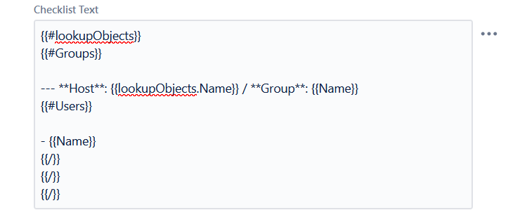

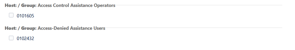

When I'm cycling through the values I want to divide them by Groups, but before the name of the Group there should also be the name of the Host it belongs too, this is what I have:
Which results in this:
The value after the "Host:" is missing, how do I access the {{lookupObjects.Name}}?
Thank you

Bill Sheboy
September 27, 2023
Hi @DavidBernardoSI1996
First thing, I am not using Assets and so my suggestion is based on what I understand about rules.  With the disclaimer out of the way...
Once you are inside of a rule iterator like {{#lookupObjects}} it can only see that information at that point, and lower.  And so referencing {{lookupObjects.Name}} will not work inside that loop.
And also...you are trying to access the Host name inside of the {{#Groups}} iterator; it is no longer visible.
One alternative is to create a separate Host heading, and then add the lower level items.

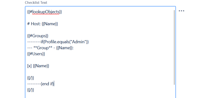

DavidBernardoSI1996
September 28, 2023
I've changed the format, so that instead of:
HostA - GroupA
HostA - GroupB
It's like this:
HostA
   - GroupA
   - GroupB
But now I have a different question, what if I wanted to compare a value to make it so it only renders the group and its option if Profile = Admin, like so:
Bill Sheboy
September 28, 2023
If the attribute is visible at that point, you can use list filtering and conditional logic for that: https://community.atlassian.com/t5/Automation-articles/Filtering-smart-value-lists/ba-p/1827588
Your change is close, and with a slight adjustment, and let's assume your Profile is defined in the Group, the change would be:

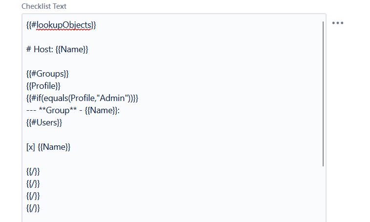

DavidBernardoSI1996
September 28, 2023
I've tried with the code you sent me, but I'm not sure why it isn't working, none of the groups are showing up, so after that I wrote the value inside Profile, like so:
And this is what I got:
Not sure why the equals is not working
Bill Sheboy
September 28, 2023
What is the type / structure of Profile?  I suspect it may not be just text and instead has a lower level attribute that represents the "Admin" you are testing.  You can confirm that by writing the entire {{lookupObjects}} result to the audit log.  And once it is found, add the attribute to the filter.
For example, let's assume Profile has a Type, Name, etc. and the Name is the one you want.  The filter would become:
{{#if(equals(Profile.Name,"Admin"))}}

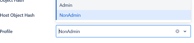

DavidBernardoSI1996
September 28, 2023
I've also tried the .Name, and nothing is written down when I use {{Profile.Name}}, the value is a select value that only has 2 option, "Admin" or "NonAdmin"

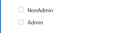

DavidBernardoSI1996
September 28, 2023
DavidBernardoSI1996
September 28, 2023
The images above are the field type and the selectable values
Bill Sheboy
September 28, 2023
What do you see in the audit log if you write the entire {{lookupObjects}} to the audit log?
If it is a single-select as shown in the image, perhaps try this:
{{#if(equals(Profile.value,"Admin"))}}

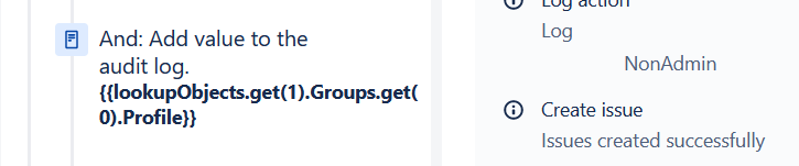

DavidBernardoSI1996
September 28, 2023
I did this audit log to see what it returned, and everything looks normal:
Bill Sheboy
September 28, 2023
When you explicitly write just Profile to the audit log, I wonder if it is only showing the default attribute.  That is why I suggested writing the entire thing as it would show the entire JSON structure: {{lookupObjects}}
We can also try some hackery...forcing the expression to text like this:
{{#if(equals(Profile.toLowerCase(),"admin"))}}
