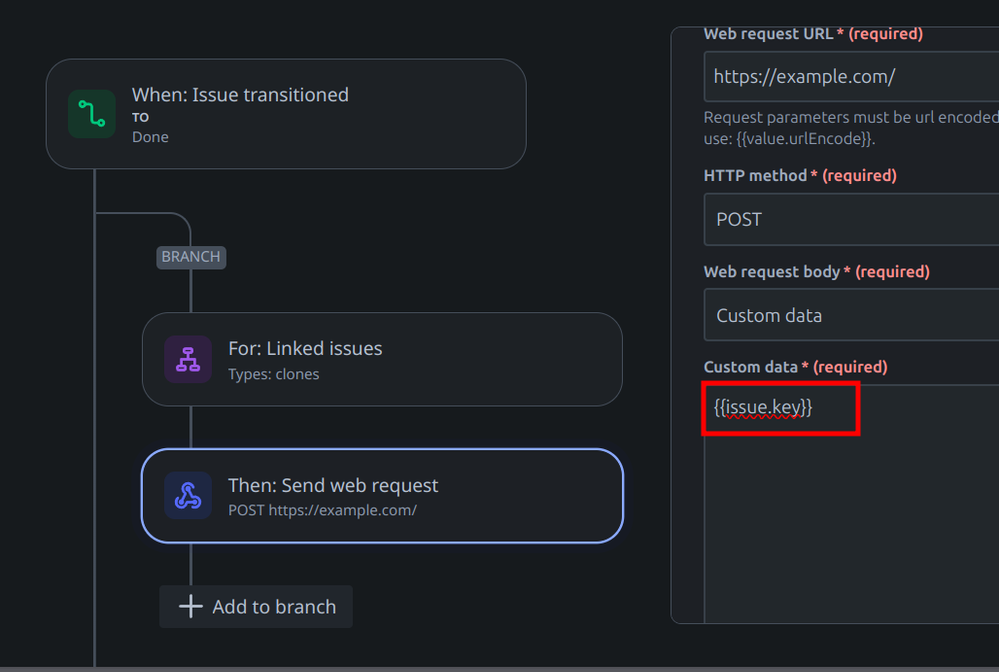

I have two projects TM and CO. When in TM, an issue is created, same issue is cloned to CO and a Cloners link is created between both issues.
What I want to do is that when the issue in CO is transitioned to Done, it should send a web request having the key of parent issue in TM project in its parameters or body. I am unable to get the link between both issues. Here is what I have tried
  But, this condition never triggered. It always ends up with this response
I am unable to get what I should do regarding this as I am totally new to automation in Jira.

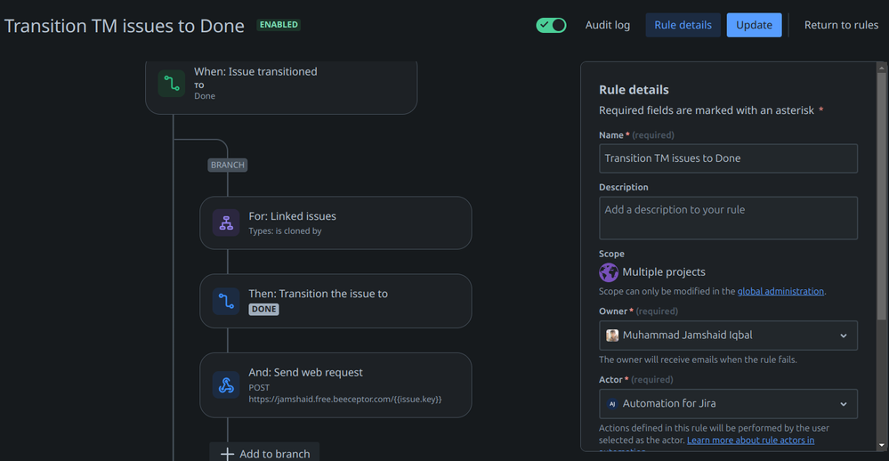

I had to transition the linked issue to Done state and send a web request containing the parent issue key. Here is how I did it. I created a shared rule between both projects and then used the following automation flow to close the issue and send web request.

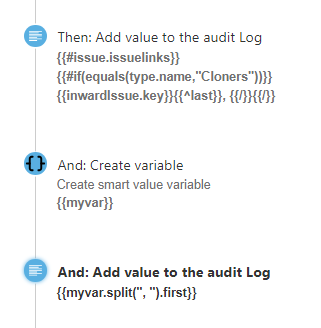

My proposal was, Before your branch, first please try to log below smart value, should pull the list of keys.. modify the if condition accordingly.
{{#issue.issuelinks}}{{#if(equals(type.name,"Cloners"))}}{{inwardIssue.key}}{{^last}}, {{/}}{{/}}{{/}}
You then convert this into a list by first storing above smart value into a variable (myvar) and doing a split. {{myvar.split(", ")}}, now you have a list of keys.
If you want to loop through and make a web request call for each of "parent" /original cloned link, I believe you can do an "advanced branch" afterwards on  {{myvar.split(", ")}} and make your web request calls for each "key" that way. Something along the lines of below thread or similar posts which loop over a list.

Kalyan Sattaluri
February 13, 2024
@Jamshaid  Sure, Just edited my post with screenshot, please check and let me know

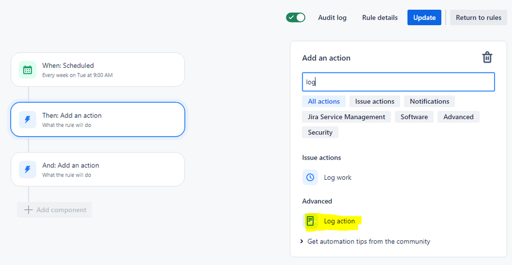

@Kalyan Sattaluri I can't find Add value to Audit Log in then: Add an action
Kalyan Sattaluri
February 13, 2024
In cloud, its called "Log action", please verify.

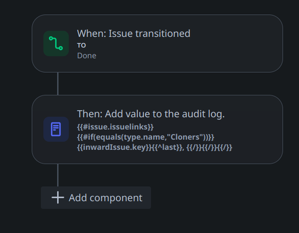

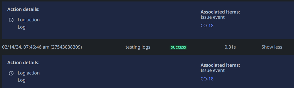

Jamshaid
February 13, 2024
@Kalyan Sattaluri

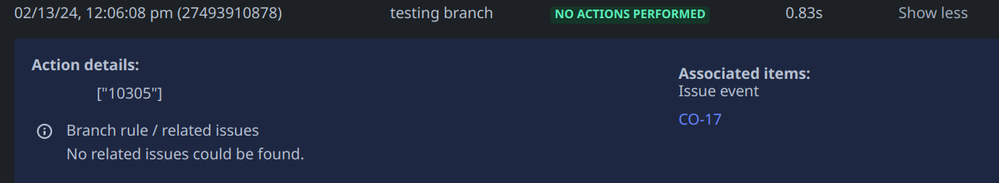

Here is what appears in logs. It does not print anything from issue
Here is my rule

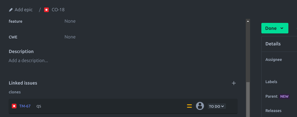

Here is the issue CO18
Kalyan Sattaluri
February 13, 2024
Your log below has TM-63 and your screenshot has TM-67.
Please post similar log like you posted below so we can cross check that it should be "inwards" or outwards direction in our log action
Jamshaid
February 13, 2024
@Kalyan Sattaluri I have got the list of linked issues. Thanks for your help
{{issue.links}}  worked for me. It is enough for now.

Great, but the JSON you are showing again is for TM-63 and your screenshot has TM-67. I am curious whats the difference in link types between the two because syntax worked for me. Thats why I asked for JSON which showed TM-67 to look at the difference.
Either way, looks like you got what you wanted. Problem solved!

Jamshaid
February 13, 2024
@Kalyan Sattaluri The condition works with outwardIssue.key
{{#issue.issuelinks}}{{#if(equals(type.name,"Cloners"))}}{{outwardIssue.key}}{{^last}}, {{/}}{{/}}{{/}}
