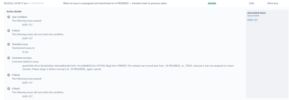

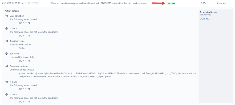

The first time the condition is triggered the rule successfully executed, when the user transitioned an unassigned issue from TODO to IN PROGRESS:

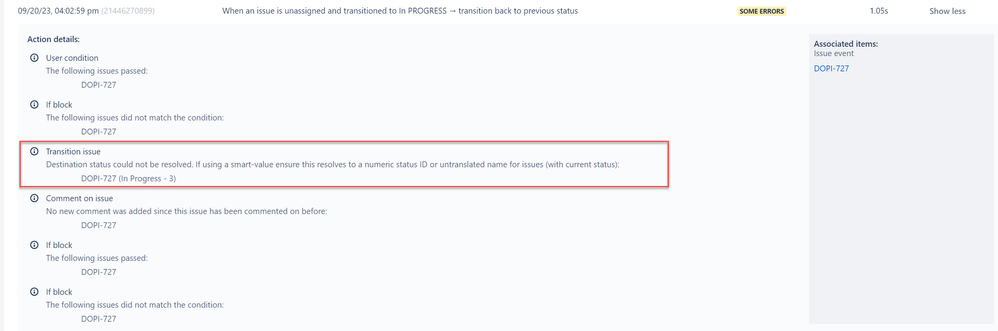

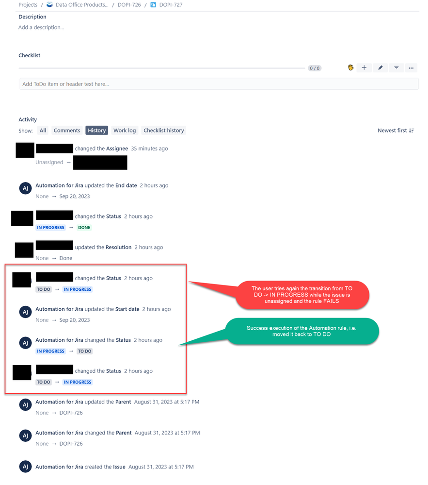

but the second time (about 15 mins after the previous trigger) failed. The rule was triggered when the user did the same operation. I got the error message:
Here is the issue history:
I highlighted when rule was triggered.
In this case, the workflow is the same, so I don't think there is workflow post-condition or function. The rule works because the first time for the same issue it worked, but for some reason it fails the second time and according to the issue history, nothing specific happened.
I am trying to find any specifics for the second case that justifies the fail, but I am not able to find it.

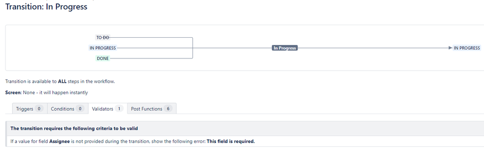

I'd suggest that its probably far more effective to add a "validator" into each of the workflows to check that the "assignee" field is populated when transitioned to "in progress" - rather than allow it to move forward and then automatically transition it back again?

@Tim C  thanks! This is a good advice, but then I depend on my Jira Admin, whenever I can, I try to solve it using Jira rule. The thing is that I was not able to find the pattern when it fails, other than it happens usually after a success execution, and the user latter tries again to transition the issue being unassigned. For example today it failed for the same issue after several successful executions.

@Tim C at the end I asked my Jira Admin for help and we implemented validator in the workflow. This is more stable, and allows to send a popup message advising the user why the transition is not allowed, so I disabled the rule.

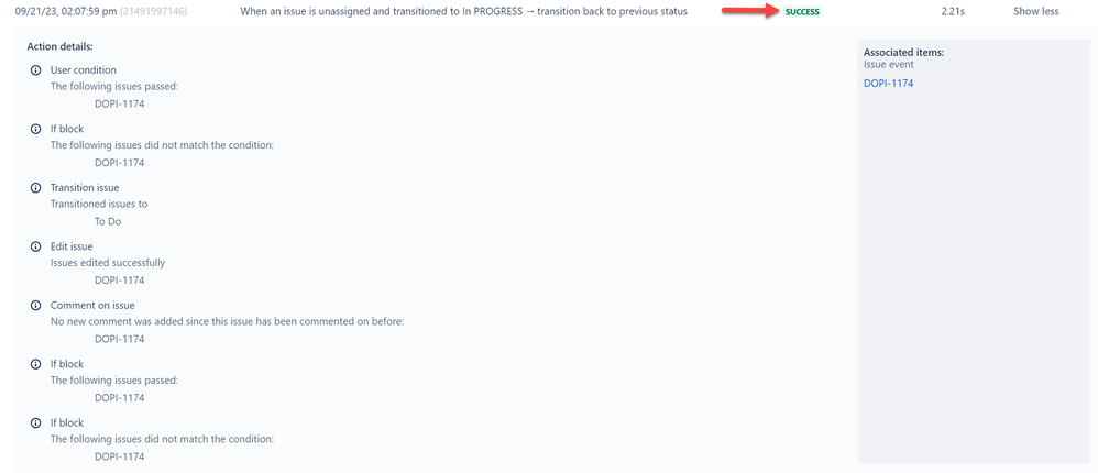

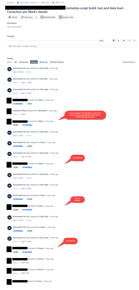

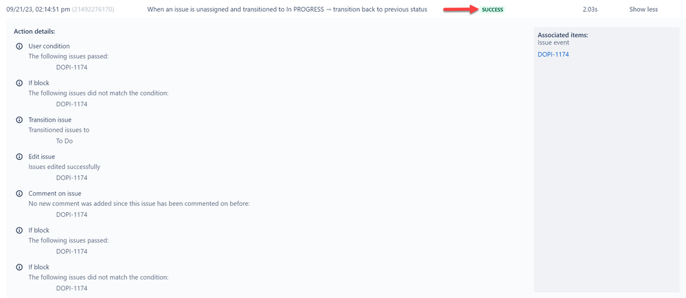

For example just looking to one issue (subtask) that executed successfully several times and then failed. Here the information with the time stamp.
This is the issue history:
Here is the log information in the automation rule:

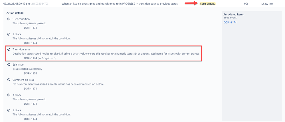

then the failed execution:
as you can see the rule executed correctly three times for the same subtask, then in the fourth attempt if failed.
as you can see it is a weird situation why it works as expected the first three times then it failed.

Thanks @Tim C that was my first assumption "timing", but the previous successful execution was at 2:14PM and the first railed execution was at 8:09PM, so there is enough time. The refetch action, has no parameters, and as per my understanding the scope is within the rule only, so invoking it before transitioning won't have effect at all, because no changes happened at this point.
You can see that the if-condition checks the status before doing the transition to make sure the issue is at the expected status before making the transition back.
I replicated in a sandbox Jira Environment the rule, to do further tests and even invoking the rule twice within the same minute it doesn't fail.
By accident when I duplicated the rule I had both rules activated and I got the error, because both rules are executed at the same time even the rule prevents a transition from the wrong status status via If-condition, it failed, so that maybe the explanation. Now reviewing the rules I have in my Jira production environment, there is no other rule that does a transition back under the same condition, so I don't know what could happened, but at least similar rules triggered at the same time and doing a backward transition maybe the reason.
I activated both rules again and I was able to replicate the error. One rule executed successfully and the other rule failed with the error I mentioned in the question. The error cannot be avoided even using re-fetch which proves that this action has effect within the rule only. Maybe the error happens under other scenario that occurred in my production environment that I am not able to figure out.
It seems to be a bug, because even the rule checks a valid status before making the transition back, this check doesn't have effect and allows to do a transition back for a subtask that was already moved to TODO due to the other rule.

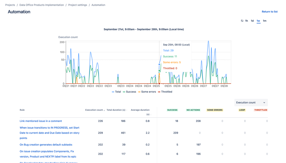

@Tim C I see, I guess you are referring to some feature only available for Jira Admin, I am just Jira project admin. I will check with my Jira admin. The only option I have is from the list of rules, click on the ellipsis (top right) corner then select: View performance insights, but the view doesn't show what other rules were executated at the same time my rule failed. I know another rule was executed to set start date, but this rule doesn't do any transition. This is what I see:
Highlighted at the time the rule failed in my Jira production instance, but it doesn't offer the sequence of the events.

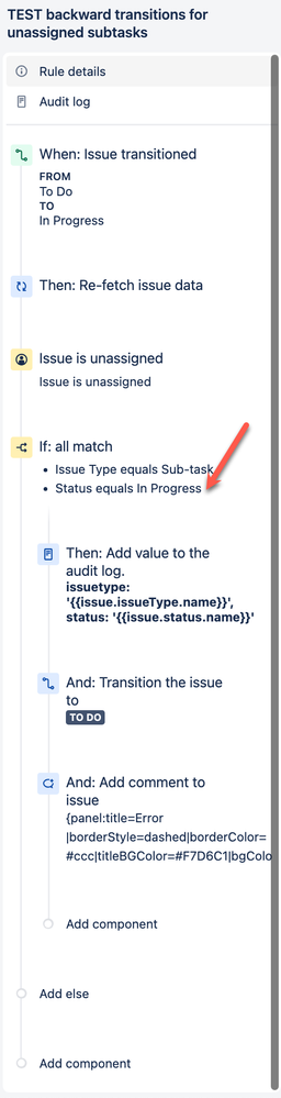

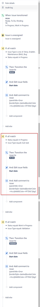

I consider it is a bug, because of the if-condition I have, it prevents to the transition back from a status other than In Progress:
so if I duplicate this rule, both of them active, now I try to move an unassigned subtask from TODO to IN PROGRESS, both rules are triggered. One rule moves the subtask back, then the other rule should not execute the transaction back, because the subtask is already in TODO status so the if condition doesn't pass, but this is not happening, it gives the error instead.
