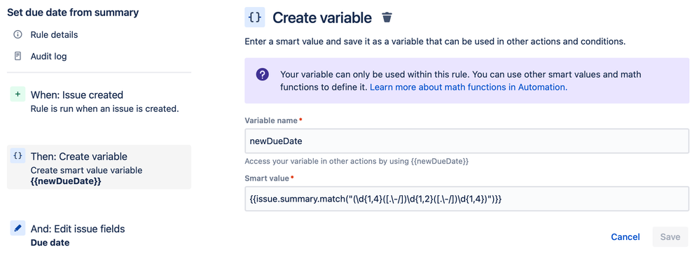

Here are the details of the Create variable action:
You can copy the smart value below:
{{issue.summary.match("(\d{1,4}([.\-/])\d{1,2}([.\-/])\d{1,4})")}}

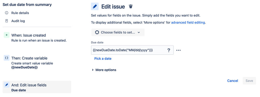

Here are the details of the Edit issue action:
{{newDueDate.toDate("MM/dd/yyyy")}}

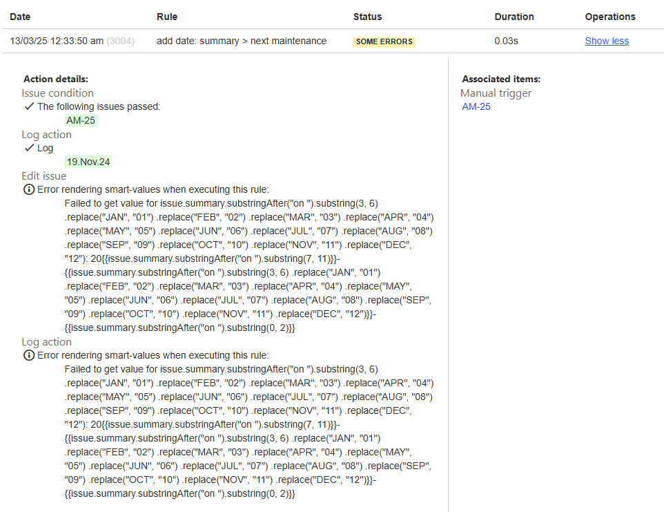

Hi @Manon Soubies-Camy ,
We have a German-format date in the Summary extracted by Assets automation (Data Center) from the relevant attribute:
Output in Summary: „Maintenance task for USI001 - LUBRICATION 12 on 18.Dez.24”
Using RegEx, we can successfully isolate the Date string, but Jira Service Management (DC) encounters an error when we want to replace the shortened Month reference with the digits:
Is there perhaps another way to get Jira to recognize our date format?
Or could we even change the format to something recognizable by Jira in the Assets automation?

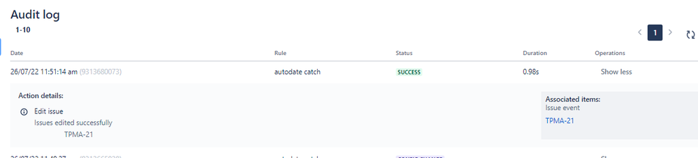

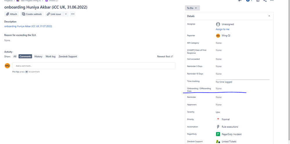

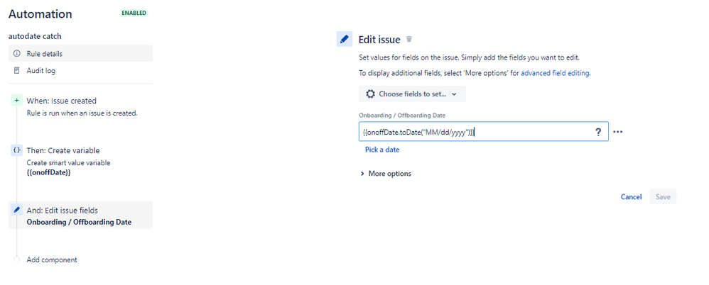

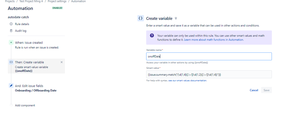

hi Manon,
I have the same issue here that I need to parse the date from the issue summary (example:onboarding Huniya Akbar (iCC UK, 31.07.2022)) then put it to the Onboarding / Offboarding Date field we have, I had checked your solution and Thomas's too, the syntax should definitely work for me too but unfortunately it didn't, there is no value for the field after the automation has been applied. any idea why?
you used on / off in the variable, you have to use the whole name onboarding/OffboardingDate
