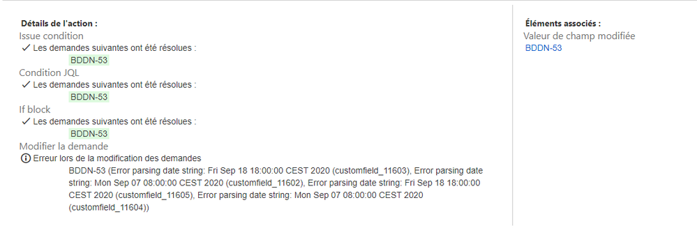

I've put in a place an automatic rule that where a date custom field takes (start date) the value of another date field (Sprint Start Date). I've been getting this error:
BDDN-265 (Error parsing date string: Fri Sep 18 18:00:00 CEST 2020 (customfield_11603), Error parsing date string: Mon Sep 07 08:00:00 CEST 2020 (customfield_11602), Error parsing date string: Fri Sep 18 18:00:00 CEST 2020 (customfield_11605), Error parsing date string: Mon Sep 07 08:00:00 CEST 2020 (customfield_11604))
Our Jira is configured in french and I suspect it has something to do with that. Any idea how I can fix this?

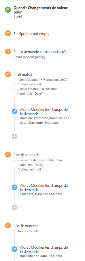

Here's the rule (in french) and its translation below:
The translation :
When : the value of the Sprint field changes
  If : Sprint is in openSprints() (JQL request)
  If : Epic Link is different than "Formations2020"
  And : "Due Date" is NULL
  And : date of issue creation is less than Sprint Start Date
    Then : Modify the value of the following fields :
       Baseline start date takes the value of Sprint Start Date
       Start date takes the value of Sprint Start Date
       Baseline end date takes the value of Sprint End Date
       End Date takes the value of Sprint End Date
  Else-if : date of issue creation is greater than Sprint Start Date
  Then: Modify the value of the following fields :
  Else-if : "Due Date" is not NULL
       Baseline end date takes the value of "Due Date"
       End Date takes the value of "Due Date"
[End of Rule]
The result of the audit log:

The translation :
[End of Rule]

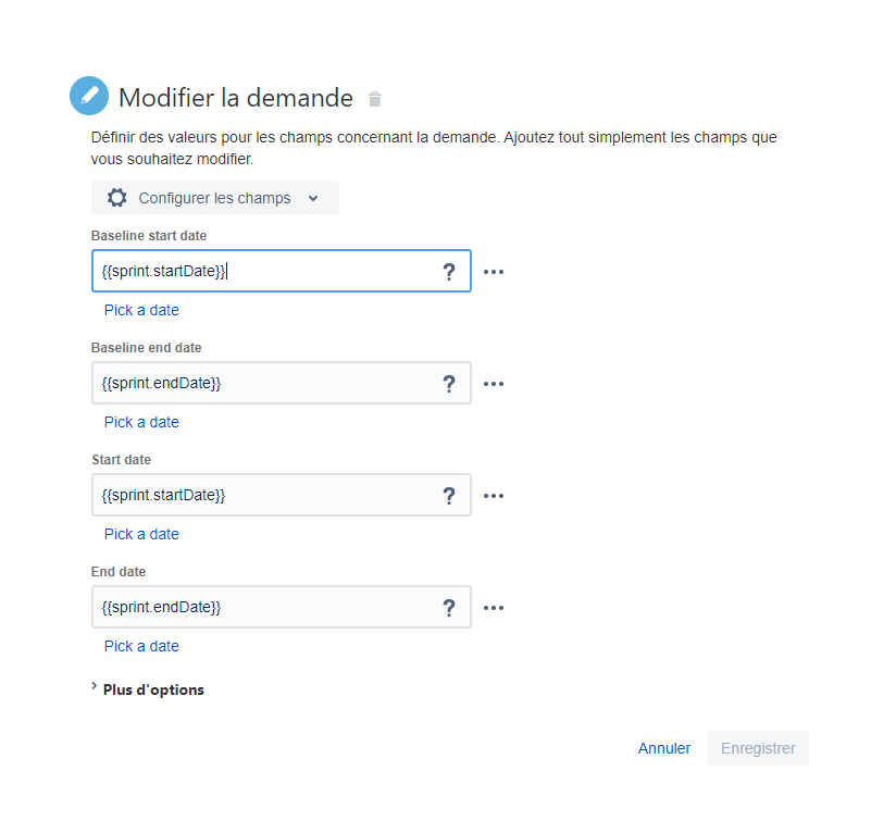

Thanks! One more share - can you show the value of one of the Alors details?
I am suspicious about the CEST being in the middle of your date that is being parsed. I believe that is what is causing it to error out.
Iana
September 17, 2020
Is this what you mean?
