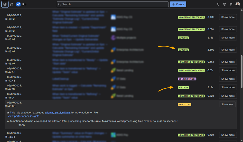

So, we've just tested this (accidentally 😆) and this limit actually applies only to 1 rule.
For example, this rule exceeded the allowed execution limit and all other rules executed successfully.
Apparently, the limit only applies to one rule, not to all rules combined. 👈
cc @Jose Gochi
