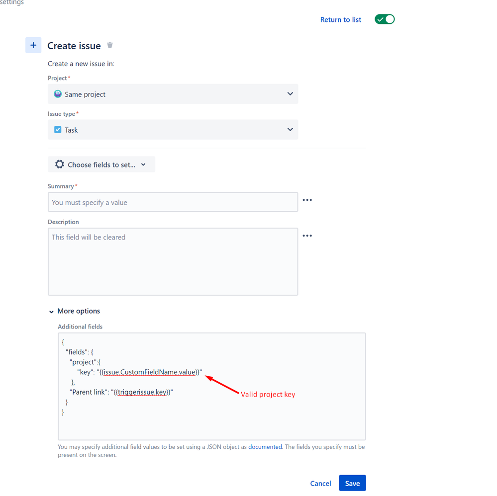

I think people are not seeing that this question has been answered, so I am re-posting @Italo _Modus Create_ 's answer as an answer outside of the the other answers thread, because I found that this answer does in fact work!
@Italo _Modus Create_ said:
I was able to achieve this by using the additional fields to overwrite the Project that I need to create the issue.
In my case I have a custom field named "Activity" and the options are
  • Task A - ASP
  • Task B - DSP
The bold section is the project that the task should be created into, so I was able to do extract the project key using substringAfter and then use to as the project key.
"fields": {
"project":{
"key": "{{issue.Activity.value.substringAfter("-").trim()}}"
"Parent link": "{{triggerissue.key}}"
 Hope this helps people find the answer! This was a big unlock for me!

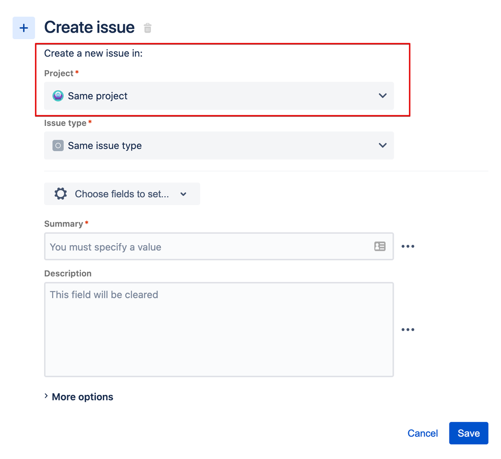

Hi @Alex Rouk ,
Not sure which Automation you're referring to. But if you're referring to Jira Automation (formally Automation for Jira) then there is an option in the UI that will do what you want to acheive:
createissue.pngCheers,
Simeon

Simmo
September 30, 2020
Hi @Alex Rouk ,
Does the "same project" option not work for you? It will try to determine it based on the trigger context. So you shouldn't have to specify a project.

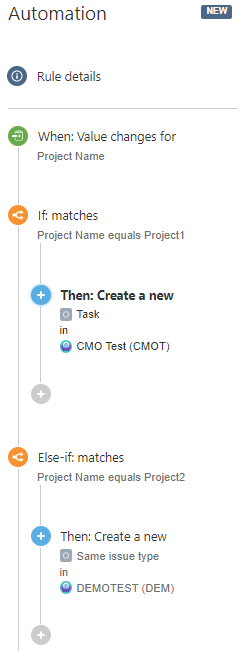

If you only have a few projects it would be easier to have a select field with project names. The automation would trigger based on that field change>IF/Else Block for each field value, then add the action to create issue for each field condition. The example below would create a Task in (CMOT) if Project Name = Project1, or Task in (DEM) if Project Name = Project2.
Like Thierry BLOCH likes this
September 27, 2022
  • Task A - ASP
  • Task B - DSP
"fields": {
"project":{
