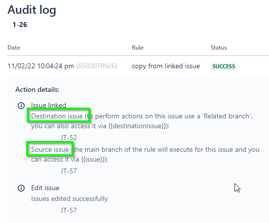

Destination / Source depends on the linking goes inward or outward from the issue you are creating:
means:
if you create task B with link "causes Task A" --> Task A is the destination/Task B the source
if you create task B with (inward) link "is caused by Task A" --> Task A is the source/Task B the destination.

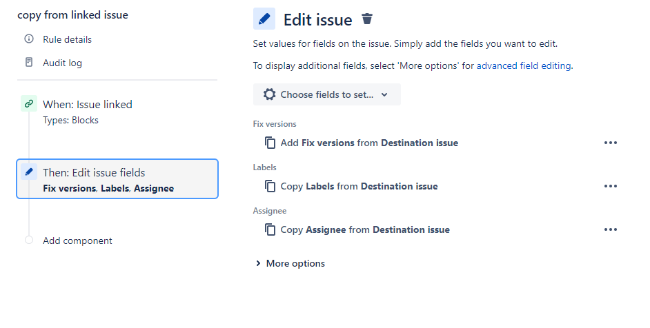

soooo......I just created an example for the linking of "blocks/is blocked by" for some investigation and as this better describes the inwar/outward - source/destination thing.
Using the "Issue linked" trigger the audit log will always tell you which issue is source and which one is the destination:
Hope this helps a little bit or gives at least a bit more input for further investigation or experiments.
Just let me know if there is more input or further question from your side. Really curious to find a solution here :)
