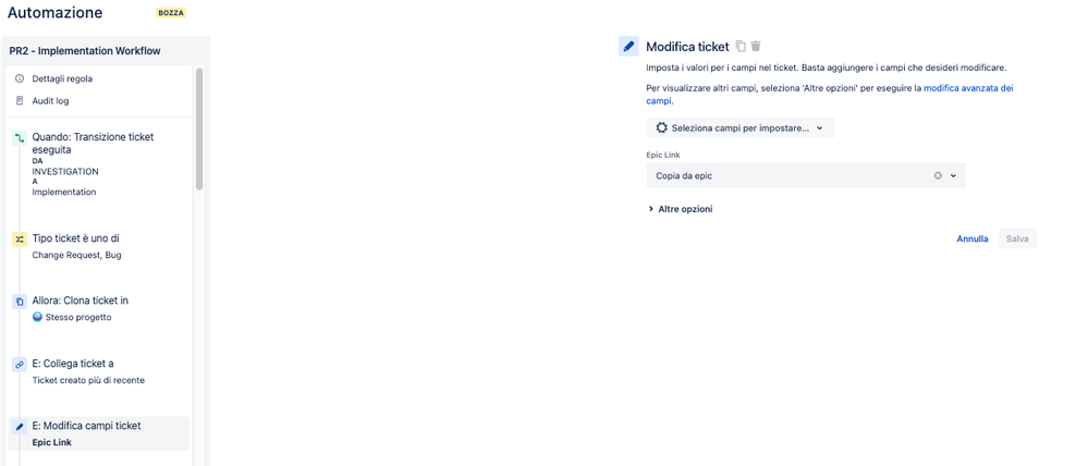

I try to modify the "Epic Link" field with no success at all
How can I fix it?

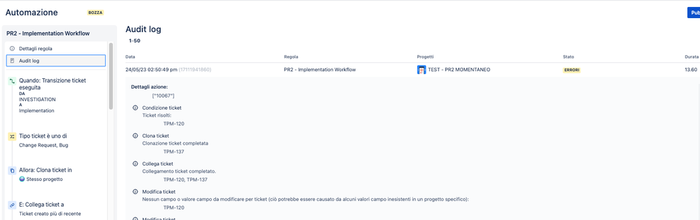

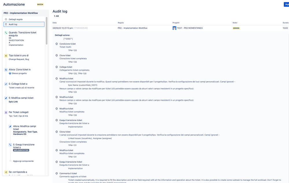

This is the answer from audit log
"No field or field value to be changed by ticket (this could be caused by some non-existent field values in a specific project):"
I know that the actual configuration is wrong, but i don't know which value could be correct

If I am reading that correctly, it looks like you are trying to make the update to the original issue and not the issue that got created. You probably want to add a Branch for Most recently created issue and put the modification there for the issue.
