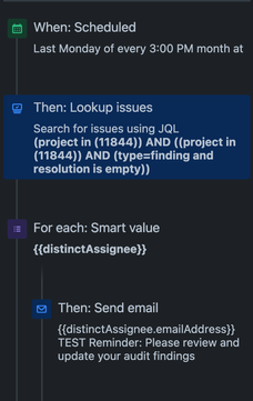

I want to create a Jira automation rule which sends out an email to each assignee based on a JQL query. The email should only contain a list with all issues assigned to the recipient.
Therefore, I created this automation:
And my email template looks like this:

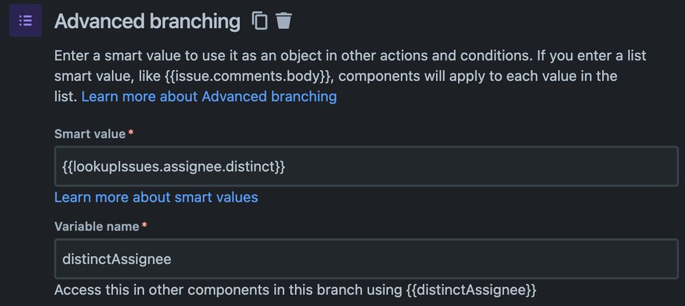

This is how I am getting my distinct assignees but maybe that's not even the best way to do it:Screenshot 2023-08-24 at 3.19.56 pm.png

OH SHOOT, there is a distinct. Nice!
