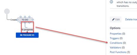

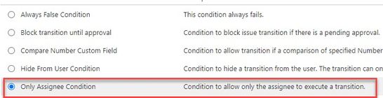

Easiest way is to set the condition in your workflow.  Im not positive on the libraries but this is the simplest method.
  1. Go into your workflow
  2. select the issue type / workflow to modify
  3. Select the transition you want to set this condition up on
  4. Click conditions
  5. Add new condition
  6. Select the "Only Assignee Condition"

As @Julian G mention you can do this without any script and you don't need any app for this functionality.
