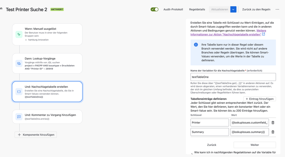

Nevertheless I'm also struggling with option 1. Here's my automation setup so far:
The lookupIssue function in this case returns 4 issues.

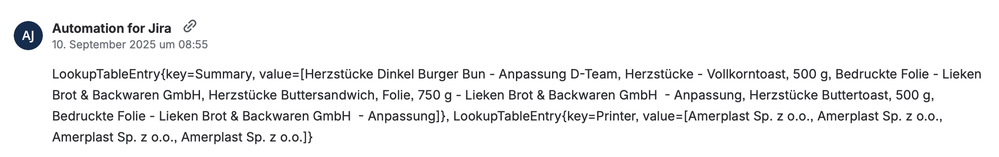

Results in the comment:
My goal is to have kind of like a list format with bullet points (or even a table, but this is for later). Kind of like this:
  • Printer 1 | Summary 1
  • Printer 2 | Summary 2
  • Printer 3 | Summary 3
  • Printer 4 | Summary 4
Any ideas how to get the lookup table formatted like this?
Bill Sheboy
September 10, 2025
Hi @Marvin Brand
For that first method, you may store the entire {{lookupIssues}} result in the table, and then use it directly.  This is a good technique to have multiple lookup results as it preserves the object structure.
For example:
  • action: lookup work items, with your first JQL
  • action: create lookup table
    • variable name: varFirstTable
    • row
      • key: First
      • value: {{lookupIssues}}
  • action: lookup work items, with your second JQL
    • variable name: varSecondTable
    • row
      • key: Second
  • then, to use these results...
My First Results:
{{#varFirstTable.get("First")}}
* {{key}} -- {{summary}}
My Second Results:
{{#varSecondTable.get("Second")}}
