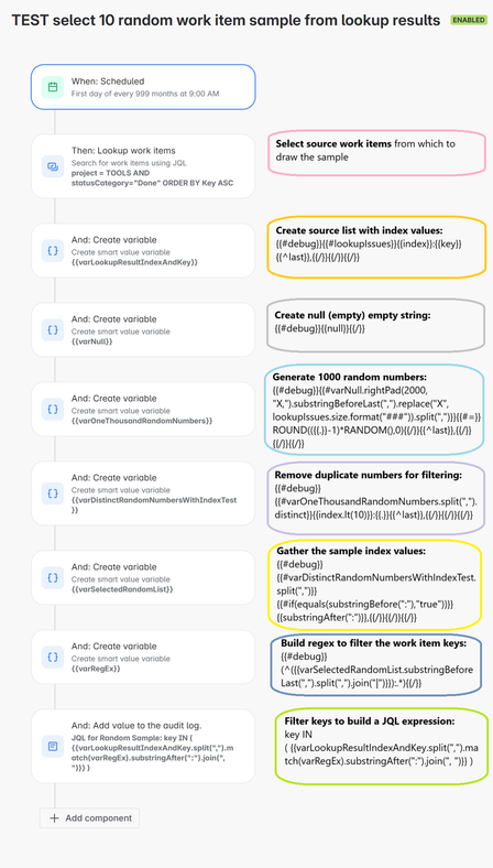

Using the rule for context, we explain how the pieces work, particularly the Create Variable actions. First, let's see the entire rule.
Other than the trigger and Lookup Work Items action at the beginning, the steps are essentially a series of Create Variable actions. These incrementally use each prior result to get to the answer.

Select source work items from which to draw the sampleWe create and test the JQL for the source work items. My example rule only looks for completed items for a single project: project = TOOLS AND statusCategory="Done" ORDER BY Key ASC You could add additional criteria, such as the work items completed within the last quarter using JQL functions, such as startOfMonth() and endOfMonth() with adjustment parameters. Remember this rule action can return up to 100 work items. Please see "Exercises for the reader" at the end of this article when you have more than 100 items.
Create a source list with index valuesWe gather information from the lookup results, keeping only the work item key and the position in the list: the index. That is stored in a variable for the final filtering later.
{{#debug}}{{#lookupIssues}}{{index}}:{{key}}{{^last}},{{/}}{{/}}{{/}}

Generate a large pool of random numbersWe will need two variables to generate the large pool of numbers...
{{#debug}}{{null}}{{/}}
Variables cannot be created empty in the rule editor, but we need an empty one as a starting point for our next expression. There is no smart value {{null}} and when an unknown smart value is used, that evaluates to an actual null value. And that then creates an empty string: a string with a length of 0. We covered this technique in the earlier article on using variables as numbers.
{{#debug}}{{#varNull.rightPad(2000, "X,").substringBeforeLast(",").replace("X", lookupIssues.size.format("###")).split(",")}}{{#=}}ROUND(({{.}}-1)*RANDOM(),0){{/}}{{^last}},{{/}}{{/}}{{/}}

Remove duplicate numbers from the poolThe sample we created has no limitations, and as we see above, it contains duplicate values. We need to eliminate those with the distinct function, and then get just the first 10 distinct values. And so, we run into the next challenge: although the {{index}} smart value would seem to help accomplish this, it cannot be used inside of a list filtering, conditional expression. We will defer this: check if a number is in the sample, but do no filtering yet.
{{#debug}}{{#varOneThousandRandomNumbers.split(",").distinct}}{{index.lt(10)}}:{{.}}{{^last}},{{/}}{{/}}{{/}}

Gather the sample index valuesThen with one more variable, we get the actual list of indices in the sample:
{{#debug}}{{#varDistinctRandomNumbersWithIndexTest.split(",")}}{{#if(equals(substringBefore(":"),"true"))}}{{substringAfter(":")}},{{/}}{{/}}{{/}}

Build a regular expression to filter for the work item keysWe have our list of indices, and we need to filter for the work item keys. We do that with a regular expression and the match() function.
{{#debug}}(^({{varSelectedRandomList.substringBeforeLast(",").split(",").join("|")}}):.*){{/}}

Filter keys to build a JQL expressionApplying that regular expression to our very first variable from the Lookup Work Items result, we get what we wanted: JQL for Random Sample: How does that work...

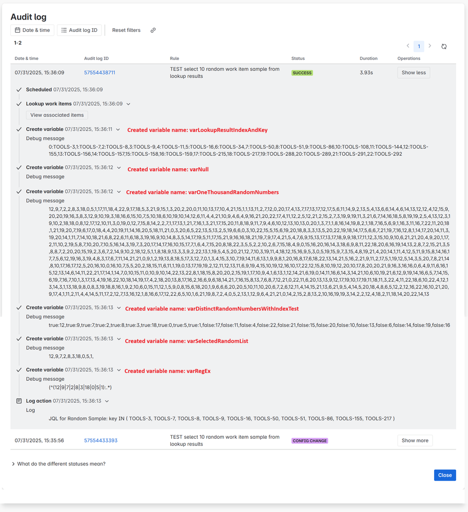

Our rule is complete, and we can test it immediately (as it has a scheduled trigger). Here is a sample of the audit log with the results. I added the names of the Created Variables so you can see what the intermediate results look like...all the way up to the final JQL expression to return our sample. And, I expanded each debug section to show the details; by default, those are not visible in the log.
