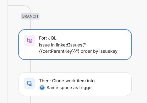

In a nutshell, I have a bunch of tasks linked to a "parent" Epic. (They aren't actual child tasks because they're under a different Epic. It's complicated and I'll explain it in a separate article if I get this working.)
So I'm using a Branch rule / related work items with the following JQL query:
issue in linkedIssues("{{certParentKey}}") order by issuekey
So yeah, the query returns ISSUETMP-6808 , ISSUETMP-6809 , ISSUETMP-6810 , ISSUETMP-6811, ISSUETMP-7298 , ISSUETMP-7302, in that order.
The thing is, the person who requested this automation would like those tasks to be kept in the same order.
And well, since we've been waiting 5 years for actual resolution of AUTO-32, the ticket formerly known as Allow switch between parallel and sequential execution of Automation Rules ... I can't figure out how to do this.

you can’t reliably keep order when cloning from a JQL branch. Automation runs branch items in parallel, so even if the JQL is sorted, the clone actions don’t respect that order.
The only practical workaround is to add an explicit ordering field first, like a number or rank copied into a custom field, then sort the cloned issues afterward using that field. If order truly matters at creation time, Automation can’t do it today and AUTO-32 is still the blocker.
