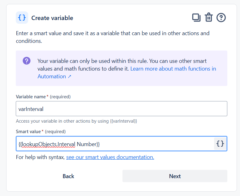

varInterval is a variable that I created in the automation rule (screenshot) following the workaround from the bug. But for some reason it does not work.

Bill Sheboy
June 10, 2025
Hi @Charlie Misonne
Although saving the asset value in the variable helps solve one challenge, your scenario has an additional wrinkle because of this limitation:
Once inside of a long-format iterator such as {{#myList}} ... {{/}} no outside data is accessible.  Only data from myList, and lower in scope, is visible.
And so your varInterval cannot be seen in the looping.
One possible fix for this is to back up a bit to the "X" values list, integrate in your interval value, and then use that in the math expression with indices.  I will list all of the relevant steps for context, changing some variable names for clarity.
