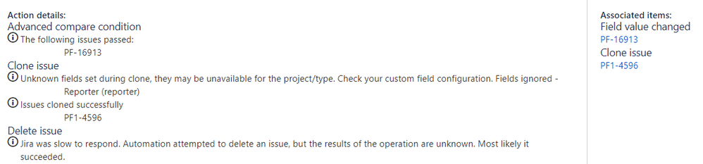

I get this particular error most often, no matter how I set up the rule: "Unknown fields set during clone, they may be unavailable for the project/type. Check your custom field configuration. Fields ignored -Reporter (reporter)". It is extremely vague, and as I've mentioned, I've checked permissions and field configurations numerous times and do not see any issue. I've tried various smart value syntaxes that I've seen but have no way to corroborate what is the right one, since other users on these forums have had success with different styles of writing and/or using the smart values, but none work for me in this case.

Also, I can confirm that the target field "Reporter" is showing on the page view configuration for both projects (they are essentially identical projects in their configuration). I can also confirm that there is not a duplicate custom field of the same name. As I mentioned above, this is the error I'm primarily battling with from my audit log:

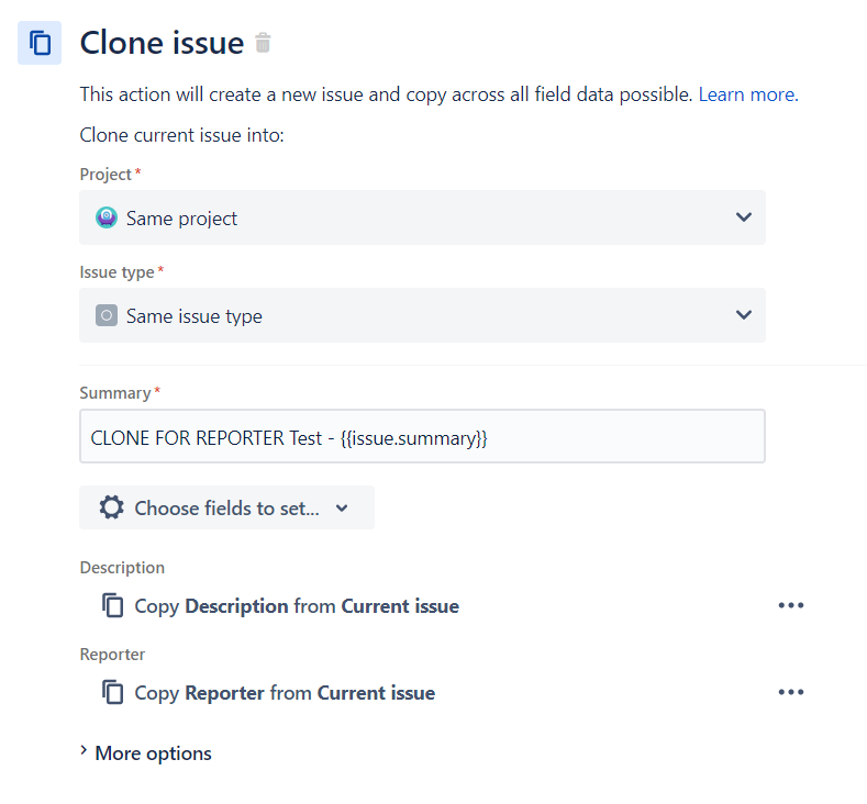

Can do!  Here is what I did:
  • Selected the clone action
  • Selected the fields I wanted
  • Selected the reporter field, selecting the ... at the right of the field and the option to copy from current issue
