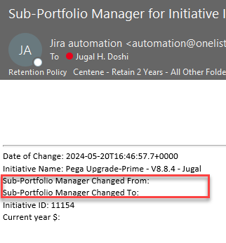

What is not working?
  • Based on the rule above, my automation output does not yield any values for 'Sub-Portfolio Manager Changed From' and 'Sub-Portfolio Manager Changed To'
  • Output Result:
    • Date of Change: 2024-05-20T16:50:15.8+0000
      Initiative Name: Pega Upgrade-Prime - V8.8.4 - Jugal
      Sub-Portfolio Manager Changed From:
      Sub-Portfolio Manager Changed To:
      Initiative ID: 11154
      Current year $:
Your help is appreciated.

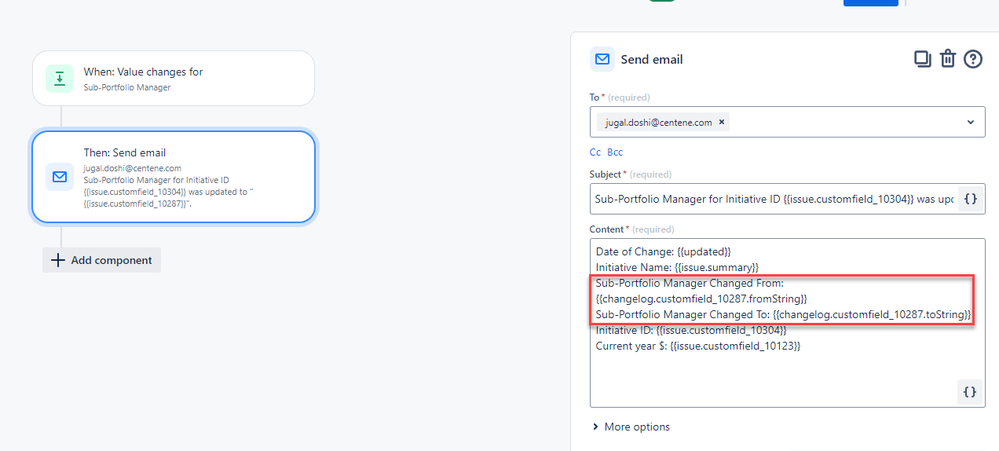

Please log these values and share screenshot if your rule / audit log
Jugal Doshi
May 20, 2024
Hello Kalyan,
Thank you for your response.
Yes, the trigger is Field Value Change. I've attached two screenshots
1) My Rule
I'm still not seeing values being populated for 'Sub-Portfolio Manager Changed From' and 'Sub-Portfolio Manager Changed To'.
