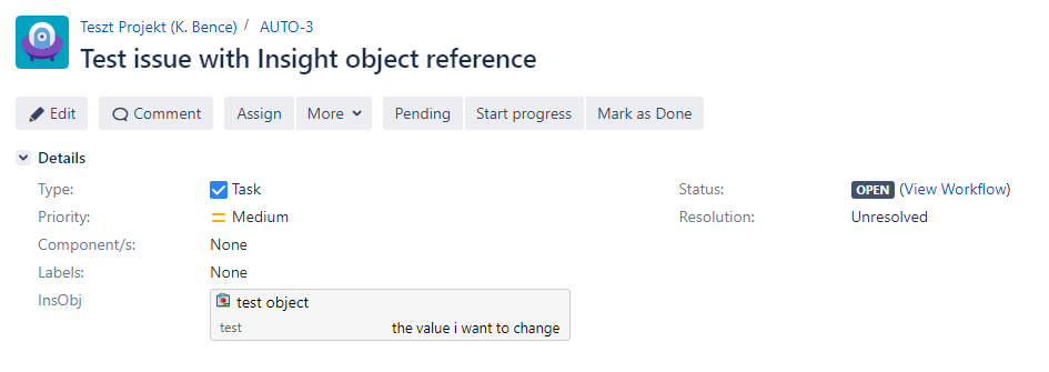

An InsObj is referenced to the issue in a custom field, as it is shown on this picture:

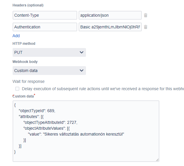

Koczka Bence
May 20, 2021
Upon sending the request via Send web request action the response is:
"401 Client must be authenticated to access this resource."
Here is the configuration of the action (the Authentication is valid, this request works flawlessly in Postman)
Any ideas?
Gareth Cantrell
May 20, 2021
Try changing the header "Authentication" to "Authorization" 🙂
Like Koczka Bence likes this
Koczka Bence
May 21, 2021
Wow, so close yet so far! Thanks a bunch!
