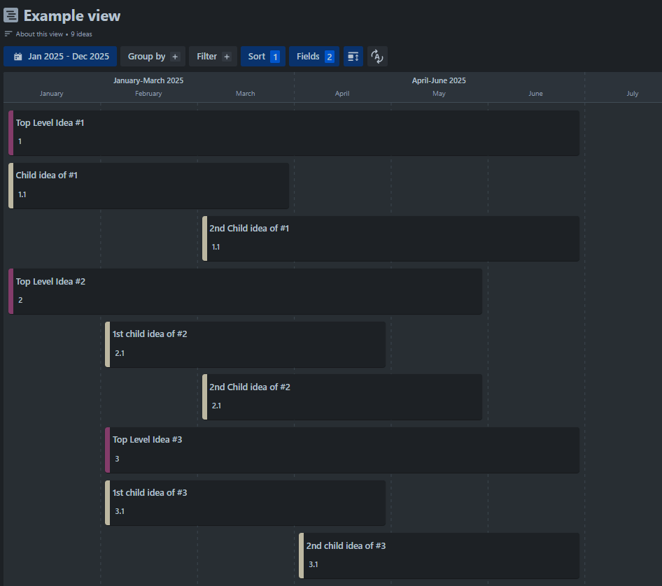

In my mind, a solution could be looking somewhere like this. The number you see is the helper value. So by sorting low to high on helper value you can make them be below their parent.

In our business Top level ideas are only committed each quarter whereas child ideas are more frequently committed to. Even though this solution requires us to ensure that the parents helper value are in iterative order. We only commit to a few (10-15 ideas each quarter) so manually ensuring there is only one full number for each parent idea isn't much of a lift.

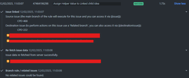

here the audit log:
I am always getting the 'no related issues be found' and therefore the edit is not happening and I don't fully understand why.

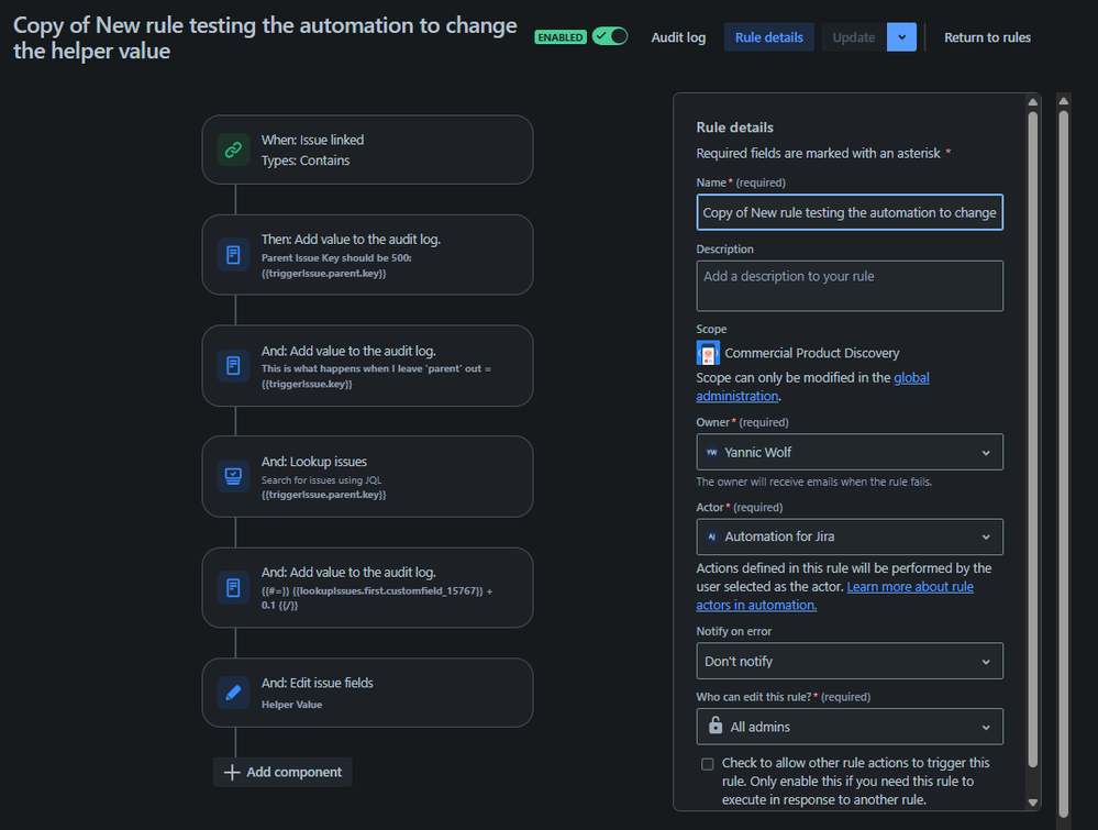

Here the overall Structure: I've put some log in there to debug which is how I found out that trigger.issue.parent doesn't return anything

You can see that the first log doesn't return anything and the second log one does.
In the edit issue I used the formula you suggested to me.
Ideally I want an automation that works both ways. Link from Child to parent & link from parent to child but I started off with just one direction, then work on the other.
Many thanks

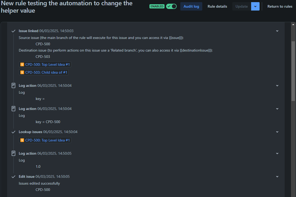

That audit log does not match the rule shown.  For example, the first write to the audit log tries this and it is not shown in the log:
Parent Issue Key should by 500: {{triggerIssue.parent.key}}
Perhaps save your rule changes, re-test, and then post both the rule and the log images again.  Thanks!

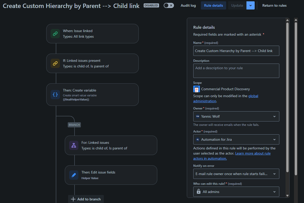

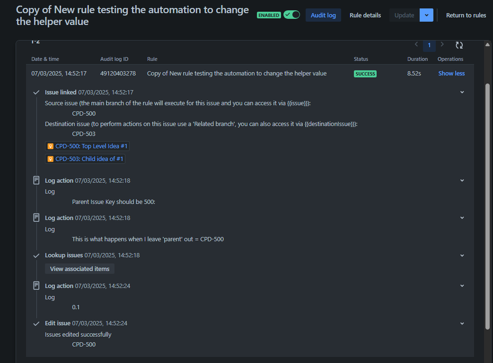

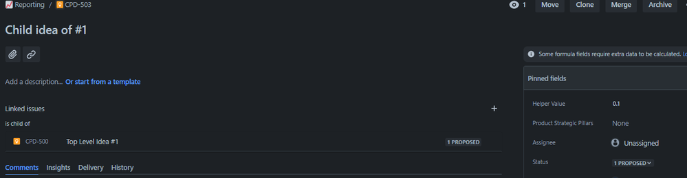

Yannic Wolf
March 7, 2025
No Problem

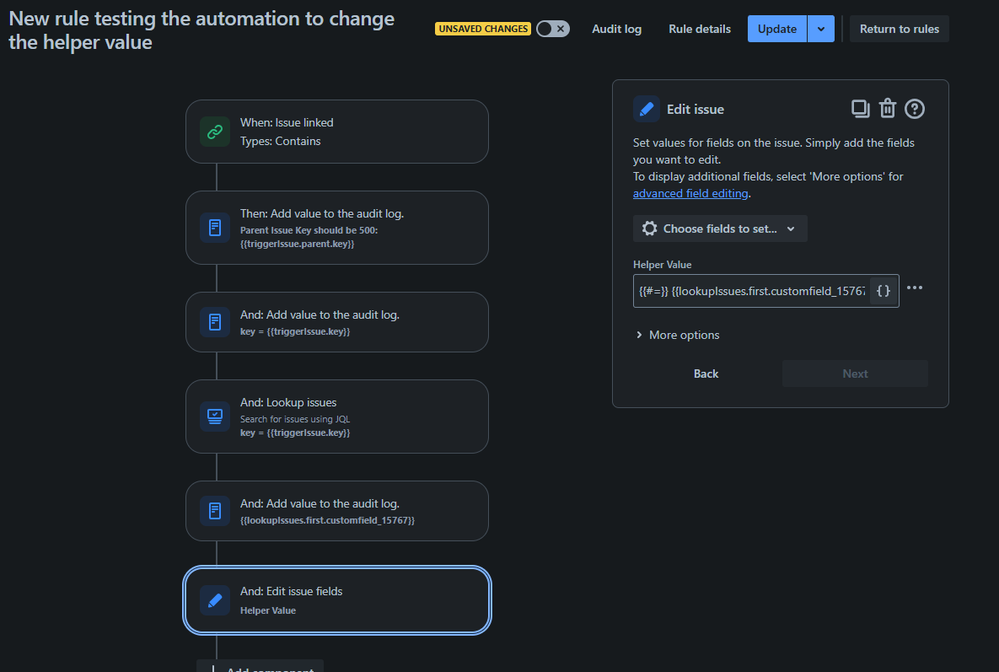

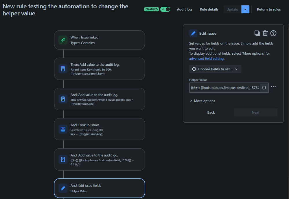

This is when it successfully fires. but changes the parent not the child value
Added two logs before the actual lookup to debug for the lookup
First log is:
Parent Issue Key should be 500:{{triggerIssue.parent.key}}
--> this one doesn't return anything
Second log:
This is what happens when I leave 'parent' out ={{triggerIssue.key}}
--> This one returns the parent
Consequently, because I want the parent to be looked up, I use
in the actual lookup action

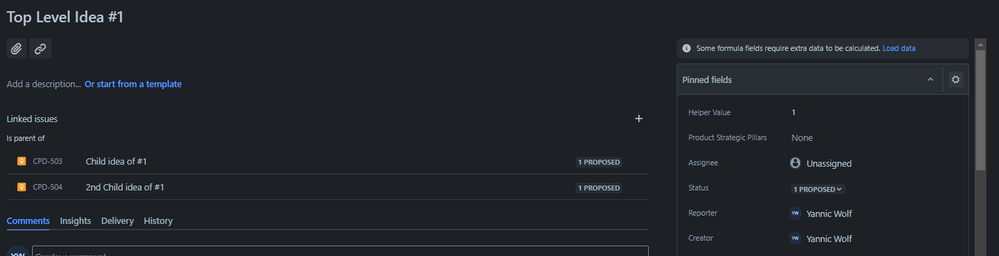

This changes the Top level idea helper value to 1.1
Now if I copy the automation and change the lookup to the .parent smart value
I get something similar, but it looks up a huge list of issues that are not children.
and this time the helper value in the top level idea changes from 1 to 0.1

Bill Sheboy
March 7, 2025
Please pause to consider on which issue this rule is starting, then which smart values should be used, and the differences between "issue links" and issue parent / child relationships using the "parent" field.
Based on the audit log, the rule triggered from CPD-500, and so this audit log write:
Will not be 500...It will be the issue that is the parent of CPD-500 (and apparently there is none).
Next, your rule is trying to lookup the same issue as the trigger with:
key = {{triggerIssue.key}}
This is unlikely to be what you wanted.
When you want to use the built-in "parent" field to manage your scenario, the rule should be triggered by a change to that field, and not on issue linking.

Yannic Wolf
April 16, 2025
Hi @Bill Sheboy
I am really sorry I don't think I received a notification when you wrote.

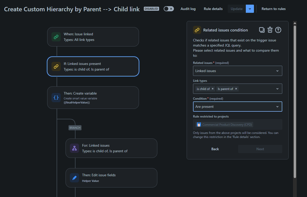

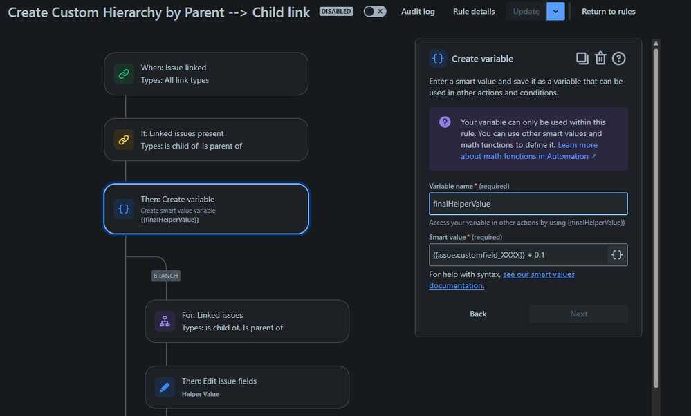

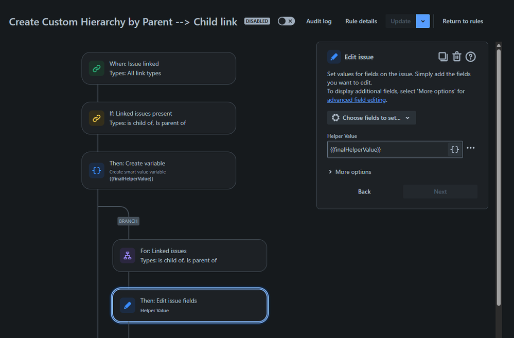

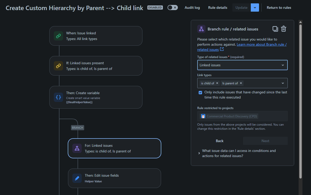

I ended up redoing the automation and it now works. It's a bit different compared to before but it works like a charm both ways by using a create variable action.
I've taken the sensitive info out so I can share screenshots so in the actual automation I used the same create variable logic to pull other custom field information from parent to child ideas, so no one has to do the manual task.
I am now trying to work out using this logic how I can pull the dates from the parent to the child because the edit automation doesn't support date type field, I believe the only way I can do that is by using JSON.

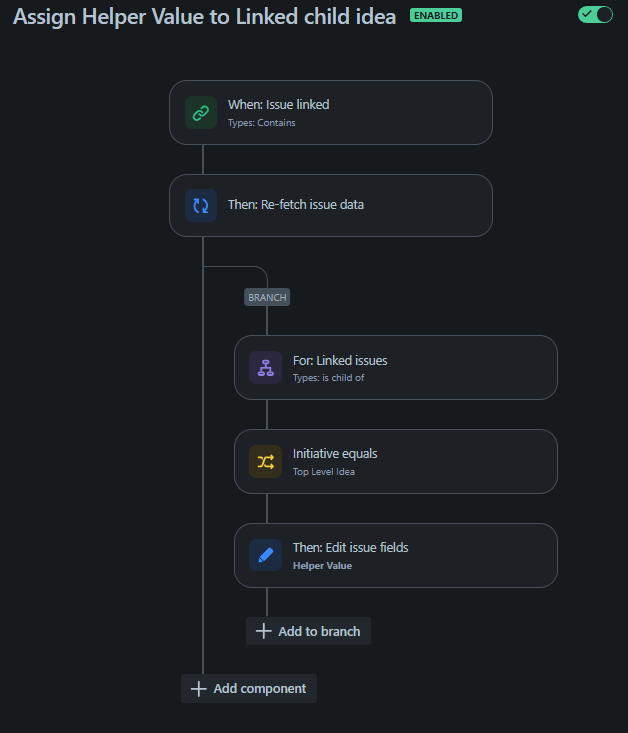

February 12, 2025
Hi @Yannic Wolf
Based on the rule and audit log images you show, the link types do not match.  Links have "direction" and so there can be different link names for the different directions.  For example, "blocks" and "is blocked by".  Have you checked the link types are correct for both the trigger and the branch?

I see. So from what perspective am I looking at this
The automation that I tested was from Child idea linking to parent 'is child of'.
Let's say I go into the child idea and link the child as 'is child of' what your are saying the branch Linked issues should be 'is parent of' ?
Also, that does sounds like I need two branches?
One if the link is generated from the parents idea to the child and one if he link is from the child to the parent?
Bill Sheboy
February 13, 2025
Short answer: maybe.
For some scenarios, rules using the Issue Linked trigger with no link-types selected will use conditions and branching to handle different link directions.  It always depends on the scenario steps done by the person doing the linking.
  • If your rule is triggering as expected with the "Contains" link-type in the trigger, next confirm what link-type should be checked for the branch, as those will be relative to the trigger issue.
  • If you rule does not always trigger when expected, I recommend pausing to map out the link-types / directions, and when you expect the rule to run.  That will guide what is needed.
