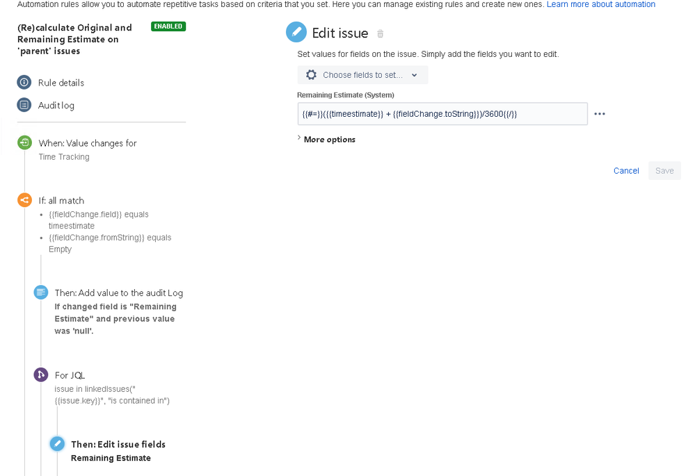

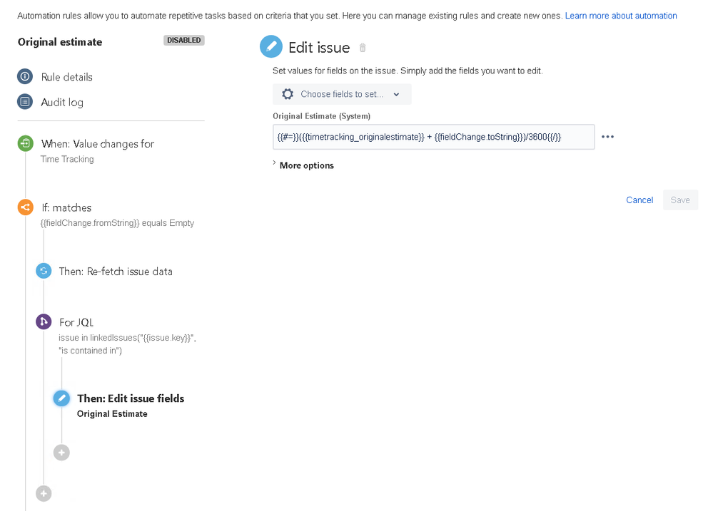

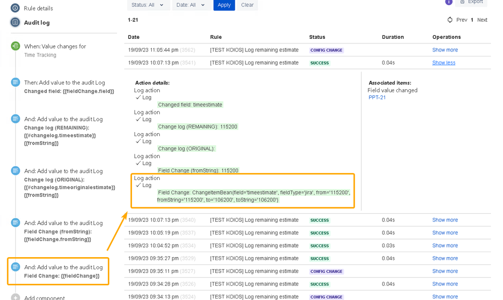

I was just working around with those (mostly with {{fieldChange}} smart value and actually I managed to get the result.
Firstly I've checked what {{fieldChange}} smart value returns and inside the results, you can check which field was changed. Regarding Time Tracking trigger, it can be either timeestime (which is Remaining Estimate) or timeoriginalestimate (which is Original Estimate).2023-09-19_23-54-26.png
Based on that, you can get appropriate values by using {{fieldChange}}{{toString}} or {{fieldChange}}{fromString}} and these can be manipulated later in the rule by using standard/math expressions.
So, I've added few If/Else blocks that have conditions based on mentioned smart values (depending if we're looking at change on Original or Remaining Estimate) and then just added an action that does a specific calculation.2023-09-19_23-54-58.png
In any case, I just needed to log {{fieldChange}} smart value first to see what I could do with the provided results.
