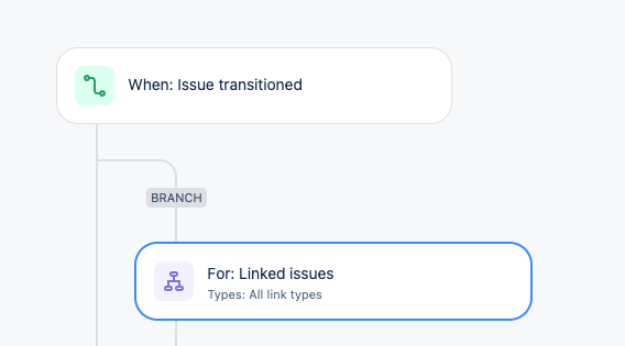

Hi @Neeta Dubey ,
In an automation rule you can specify Issue transitioned as the trigger. And in a rule you can include a Branch where you then define an action in the branch for, for example, the linked issues.
Can you continue with this information?

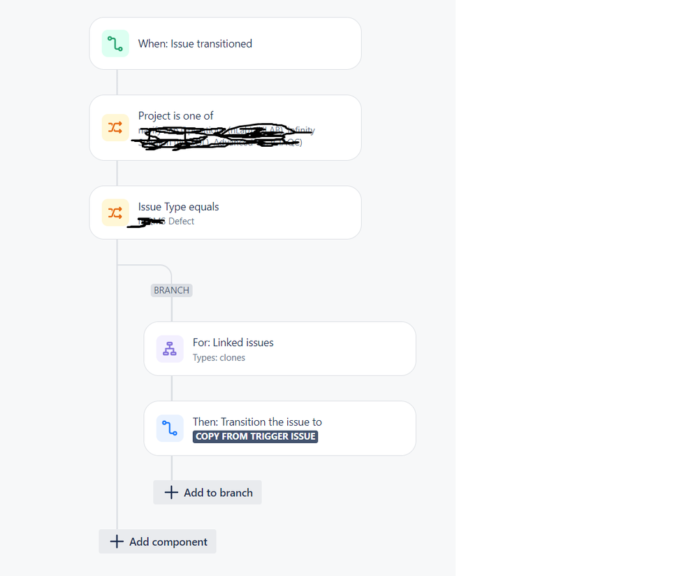

Hi Dexter,
thank you so much for info it works well when cloned issue is in the same project although I've included both the projects in scope.
it faild when I did below -
I created defect in Project A, cloned it, moved the clone to Project B, change the status of the mqms defect in Project A, and the status of the Project B defect didn't change

Thanks Dexter, When I move ticket from Inprogress to Implemented, I've a transition screen and some validators, which is same in both the tickets, would that we causing the issue.
Also, I didnt automate it because I don't need to clone issue every time, is manual cloing is a problem.
Also, i modifed the condition to "Clones" as I would be making changes in the cloned issue.
This works well when I dont have any transition screen like moving between to do to backlog.

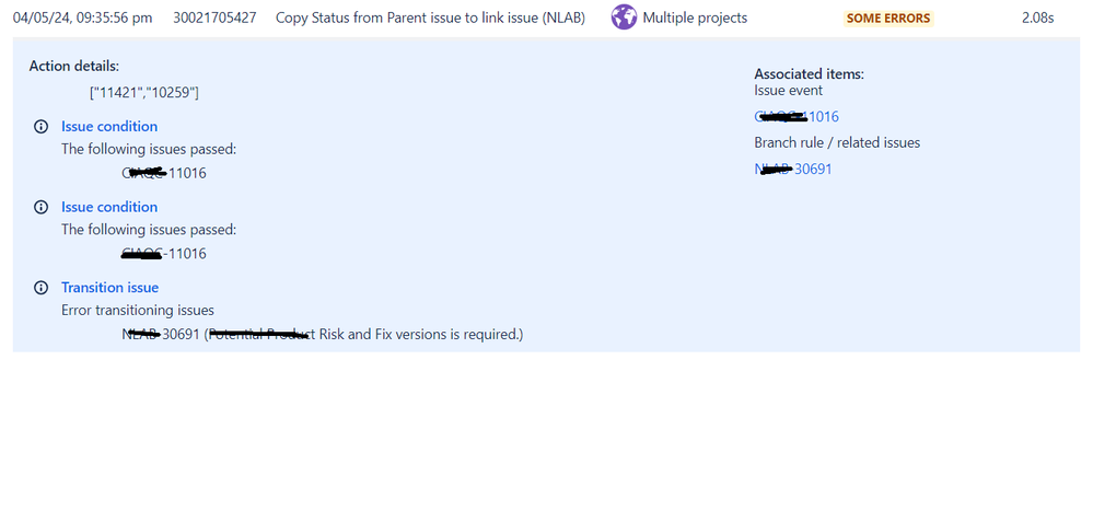

Can you screenshot the auditlog in automation. And let see what happen in automation process.
They share the same WF and transition screen, although the values are not getting copied in the destination project. If there is no validation then rule works well.
Error is because of the Fix version and Risk are required. So you may create new workflow without that validation for your Project B (if this is not required in your project B). You can just copy the workflow scheme and workflow of Project A. then update the new copied workflow, remove the validation then update your copied workflow scheme, align the new workflow in scheme then use the copied scheme in your project B. So the result will be Project A is the only one that have validation.
