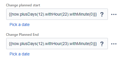

and would like to know if the same can be applied in Changed Planned Start and End Field whenever the change is created on Thursday, the Change planned Start/end date should be automatically updated with new dates.
John Funk
April 12, 2024
You could try adding a Condition at the end for Advanced Condition for
{{now.dayOfWeek}}
equals
THUR
Then add action for Edit Issue and add your two fields.
I have not tried this before so test it out. Might could do an example for today being FRI and if that works, then the THUR should work.
