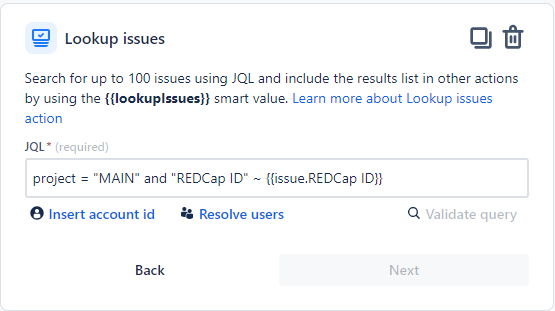

I am building an automation to link issues with the same external ID to across projects in Jira. I tried using the Lookup issues action. I started with

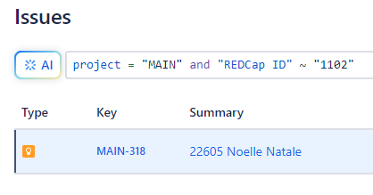

I replaced the {{issue.REDCap ID}} with an actual value, 1102, and still received that "result". The JQL with a set value works when used in Issue Search and it returns one record like it should.
Do I need to use the custom field id number in the automation JQL? Any other ideas why it isn't returning results?

Hello @Aron Kuch  As @Mark Segall  has suggested do try surrounding it in quotes... But one other thing, You mention you are searching across projects, please also make sure your rule scope has "MAIN" project included. If you dont have scope, you wont have hits.
Aron Kuch
April 4, 2024
Ah, rule scope. I had set it to one project because I just wanted the one project to link back to the first. But appears to have limited the JQL  search to just that project.
I changed to Global scope, multiple projects could also have worked, and it ran. Thank you.

Hi @Aron Kuch - I believe what you have will work, but you need quotes.  Try this:
project = MAIN AND "REDCap ID" ~ "{{issue.REDCap ID}}"
Aron Kuch
April 4, 2024
Reasonable, but I tried that and didn't resolve.
