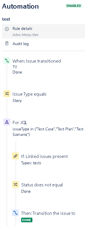

  3. I wrote a automation rule as(Screenshot) , when story is transitioned to Done, all the test case, and test set should transition to Done automatically
  4. The issue is , when I moved Story 1 to Done, the testset2 and tesetcase2 is also moving to Done.
Please help to write an automation rule to set the status as "Done" for the specific story that I selected to transition to Done. Here for eg: when I transition Story 1 to "Done", move only Test Set 1 and Test Case 1 to Done.

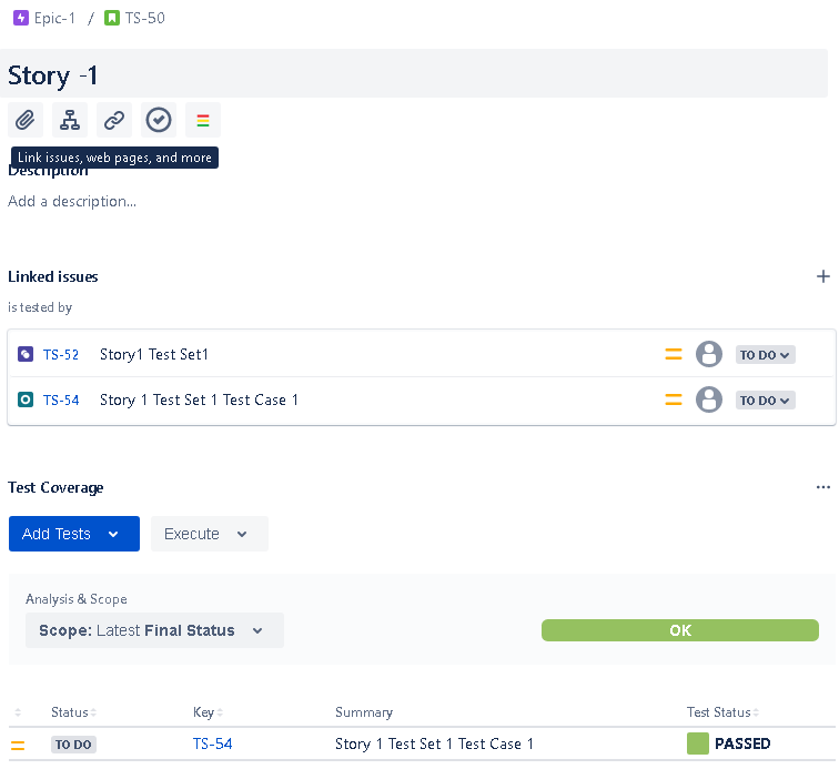

HI @Manju Nair and welcome to the community,
Could please also provide the screenshot of the rule and if possible also from the story with the linked issues?

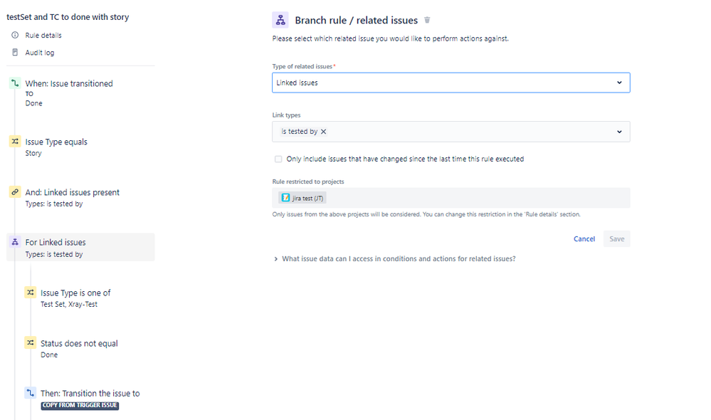

As far as I got your requirement right this rule I tested in my system does the job:
Looking forward to your feedback.
Best
Stefan
Manju Nair
March 3, 2022
Thank you so much. This correctly worked for the requirement.
