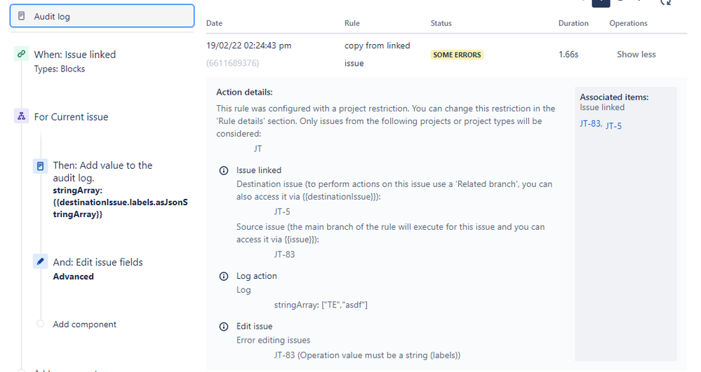

I want to add more than 1 labels from one issue to another one (eg. from parent to child) whereas the let´s say the child already got 2 labels and the parent has 2 different labels.
I tried to update a linked issue´s label field as follows:
"update": {
"labels": [
"add": {{destinationIssue.labels.asJsonStringArray}}
but audit log output says looks like:
Am I missing something? Can't this be done as simply as:

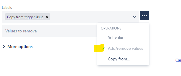

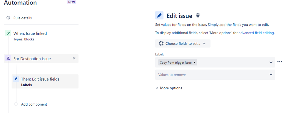

you just have to make sure you select the "Add/remove" operation.
Hooooly moly..... :o :o how could I oversee this option??? OOOOMG......
Thank you very much @Curt Holley (even if I invested the whole evening in trying to find a solution for this haha)
Well....learned a lot. therefore: it´s worth it.
Thanks guys for that great solution and lesson :)
Yes @Stefan Salzl I recall having a similar reaction 😲 upon finding the add/remove operation.
Enjoy!!

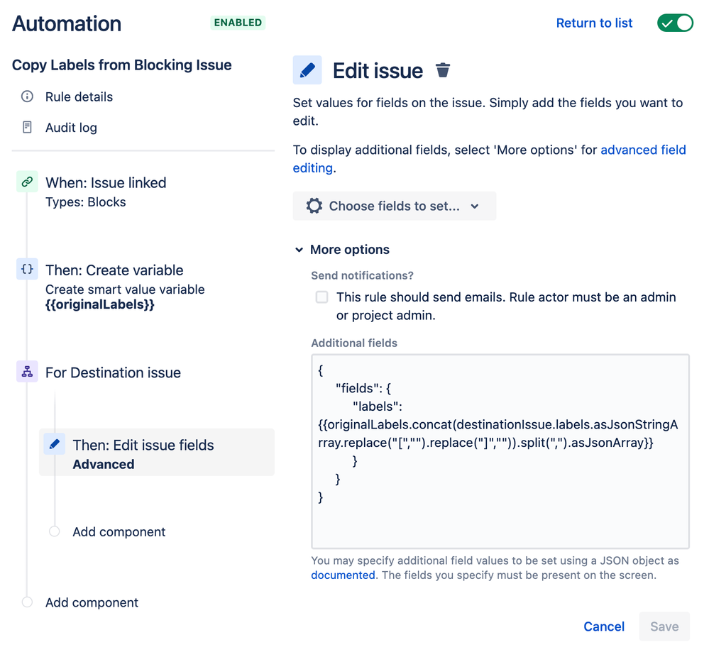

So as I mentioned in the other post, the error you got is because the "add" function can only take a string, not an array.
But after solving Dane's issue with a bunch of ugly Smart Value JSON hackery, I realized your problem wouldn't be much harder. It requires a temporary variable, because once we branch to the Destination issue, we apparently can't access the original issue's field values.
Basically we set a Smart value variable originalLabels (from the blocking issue):
{{issue.labels.asJsonStringArray.replace("[","").replace("]",",")}}
And then we Branch to the Destination issue (what's being blocked) and edit using More options -> Additional fields:
"fields": {
"labels": {{originalLabels.concat(destinationIssue.labels.asJsonStringArray.replace("[","").replace("]","")).split(",").asJsonArray}}
So it ends up looking like this:
Let me know if this works, and if so, can you vote for this answer?
Thanks!
uff.....a lot of things for me to learn from this example :) Haven´t been using smart value functions but will definitly take some deeper insights to understand what is possible with replace, split, etc.... :o :o

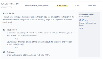

unfortunately the solution doesn´t work. See my audit log:
AH, I think I forgot to take into account this case:
* If the blocking issue (originalLabels) does not have any labels, then I should not include a comma.
Basically I ended up it trying to update with this invalid JSON for labels:
"labels": [,"childlabel1","childlabel2"]
(Note the extra leading comma.)
Ugh.... I think this can be fixed with some conditional array trickery or by adding a condition to skip the edit in case the blocking issue has no labels, but @Curt Holley has already provided a much. better. answer.
